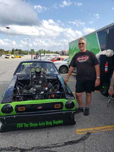

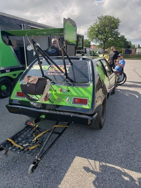

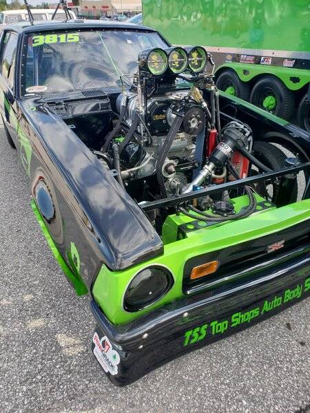

Well since I'm still waiting to get the Dart certified for the road.... went to local cruise night tonight and loan behold my buddy big Harold ( keep in mind he's crowding 7' tall and 63 )was there with his Gremlin. He's spent the last couple years redoing some different things on the car ie: paint / motor / all the electrical/ the hauler and truck that pulls it. Almost ready for its first pass at the track. Awesome job imo.

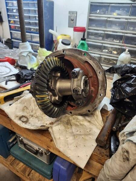

After a bunch of shake down runs I wasn't happy with rpm vs mph ( 2900-3000 @ 50 mph ) , 3/70 gears in the 9" are great for hole launch & fun factor but overall drive ability/ fuel consumption/ constant higher rpm's on the BB not so good. Ordered a set of 3/25's and installed them now ready for a test when it gets warm and some rain to wash salt brine off the roads.
