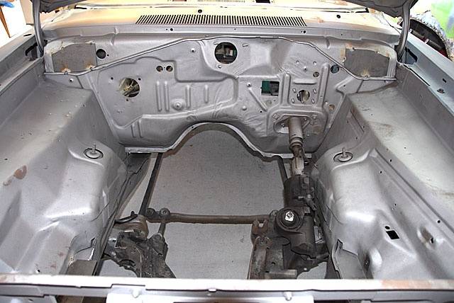

Is the shape of the tranny tunnel any different on the six cylinder Darts than on the eights?
Here is what I have in my "new" 6 cyl car:
attachment.php
The top looks awfully squared off, but I only have my '70 to compare it to and that has been hammered on BIG TIME by the previous owner.
Nope! They are the same. When they start installing cats the floor change on all A-bodies to make some room for a cat. Also, the tunnel on floor shifter manual transmissions have a large piece cut out that is covered by squared off piece "hump" that makes room for the shifter rods.
