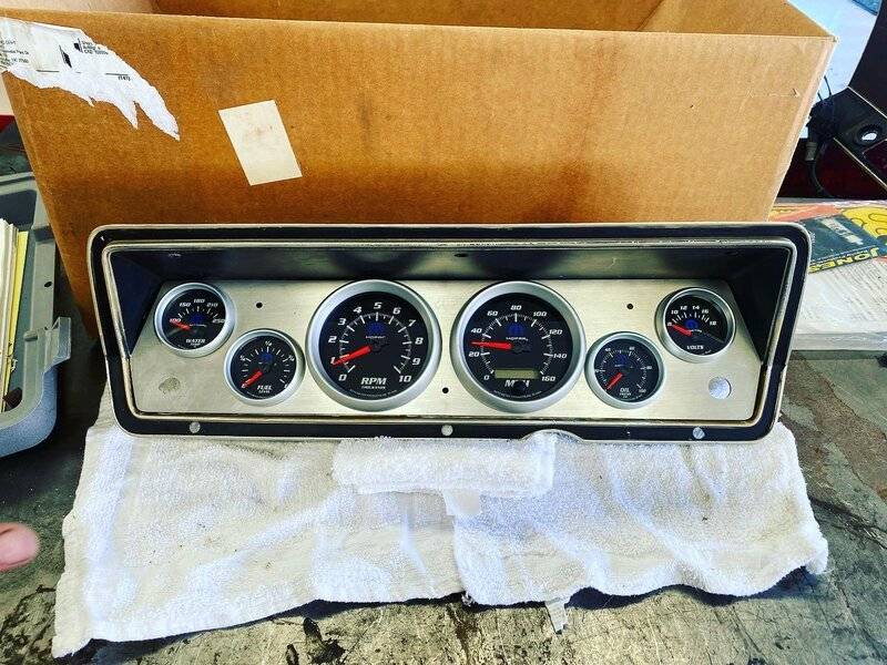

Speedway #91140355 aluminum 6 hole panel. Cost $105 bucks. Has four - 2 1/8” holes, and two 3 3/8” holes. Decided to go with black Autometer Mopar licensed gauges with a GPS speedo. One last piece that really was a game changer was the Painless gauge harness. They specifically make a harness for electric gps speedos, and a harness for mechanical as well. For me this was great because I was currently rewiring my car with a full painless harness, for those of you with the same it really makes things easy.

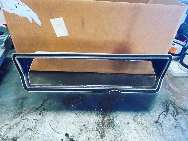

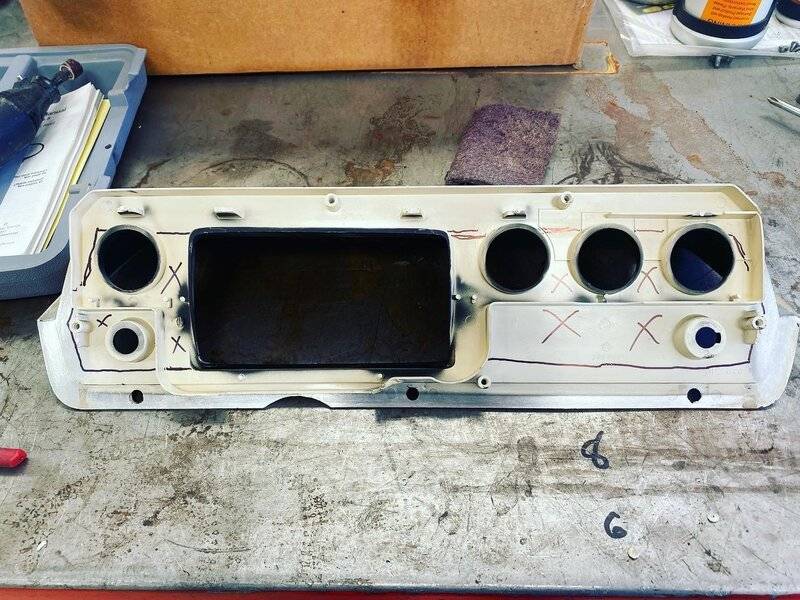

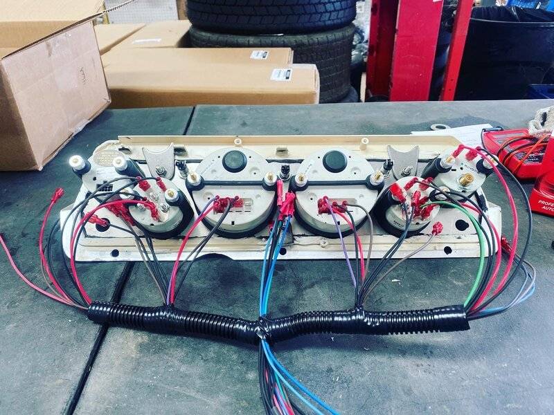

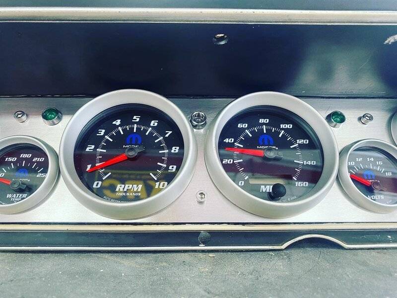

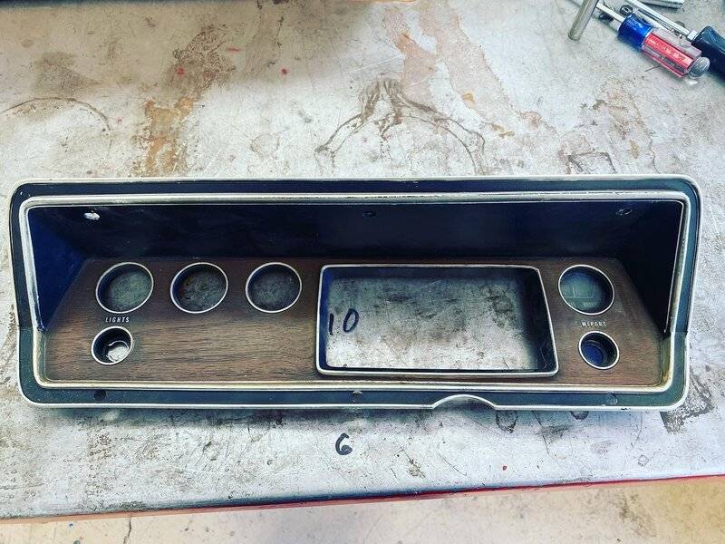

First thing I did was disassemble the original gauge cluster and separate the plastic cover. Then I mapped out the back of the plastic, leaving a generous border around the edges to trim back later. Using a tiny rotary cutting wheel I got to work. Lots of angles made the process take awhile, and the 50 year old plastic would start melting if you started going fast. Once the center was gutted, I started final trimming the edge. Leaving just enough for the panel to sit against on the front side, about 1/4”. I had to belt sand the panel on all edges to make it sit in there just right. Once fitment was good I used some black RTV and left a bead along the perimeter of the front side of the plastic and laid the panel inside. There are 3 mounting holes in the panel, I used 10/32 bolts and some roll bar weld on tabs to hold the panel firmly against the plastic and let the RTV dry. After that I set the gauges in and marked where I was gonna put my high beam and indicator lights. I went with some tiny billet LED indicator lights from Summit. With my gauges and indicators mounted I started Wiring and tying the gauges into the main harness.

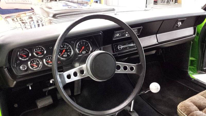

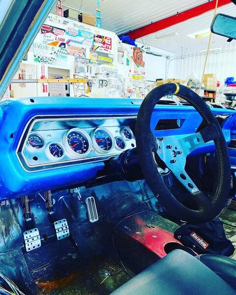

And there you have it guys. Final fitment and look for me is exactly what I wanted. Hope the pics can lend some assistance for those of you trying something similar. -Gurt
