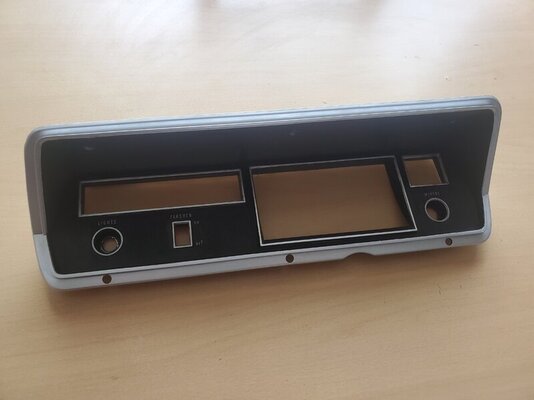

So, I tried something else : installing a 67-69 Plymouth Valiant cluster. An easier job (it's plug n play) and it's easily reversible.

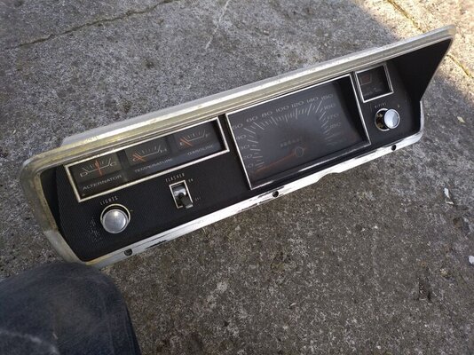

I found for sale a 200 kph '68 Valiant cluster in a correct shape, but in need of a little restoration.

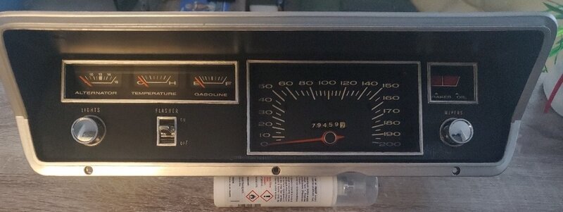

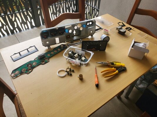

Total disassembly :
Black and silver paint job.
The clear lenses have been cleaned and polished.

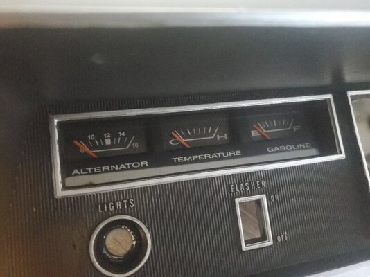

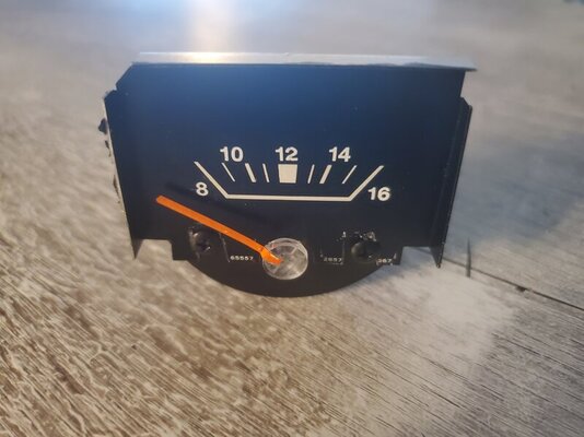

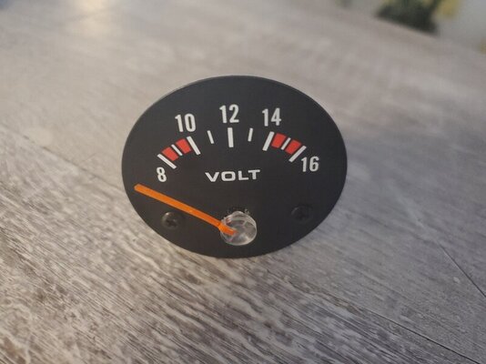

I also replaced the ammeter with a voltmeter.
For having three identical needles, I sticked on the original ammeter Mopar needle on the chinese voltmeter
And then, the original ammeter face (I erased the D and C letters, and add 8<->16 volts graduations)
New gauges :

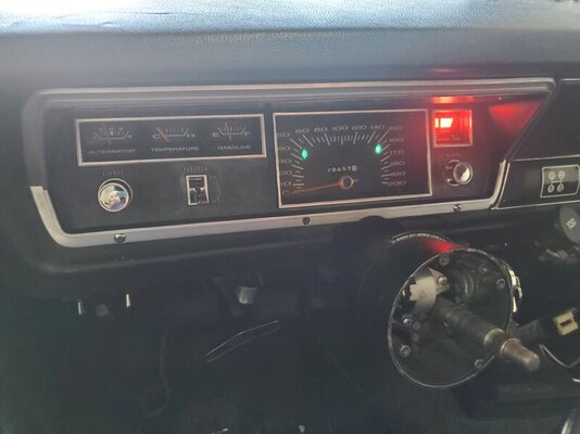

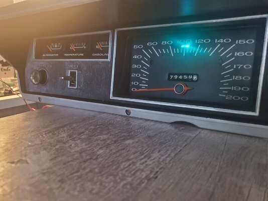

I also replaced the high beam red light by a more modern blue light :

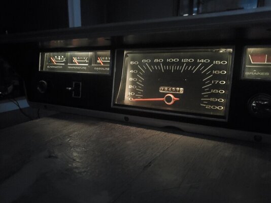

Illumination is OK

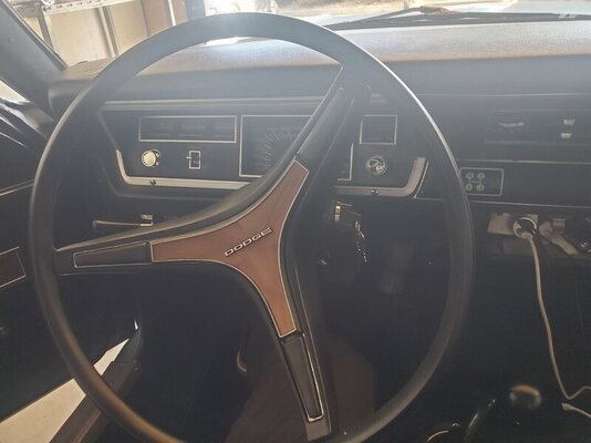

Installation in car. Everything work.
Completed work :
