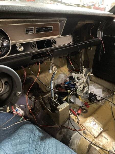

Anyone know the fix for stiff heater controls ? They always were stiff I pulled the dash for a complete rebuild and while they were out I cleaned the heater controls they were still a bit stiff but a bit better now reassemble and the top off/ heat/ defrost is just about unusable. Any kits to rebuild the cables seem fine the plastic guides had some minor cracks . Thanks
Seems to just be the tight curving of the cables when in the dash. The way I have it outside the dash it’s nice and free! Now what ?
