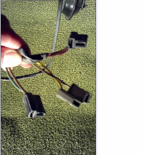

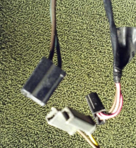

I have a 72 scamp that I am trying to get back together and I need some help figuring out what wires go where.
The first two pics are of wiring that goes towards the passengers side of the dash. Hopefully the pics are good enough for you to tell what is what. At least the connectors are on there too.
1) 2 wires (green and brown)
2) 3 wires (2pink and 1 brown)
3) 2 wires (yellow and brown)
Behind the drivers side kick panel I have the connector with a gray and a blue wire connected.
Can someone please give me some wiring info? Or a good wiring diagram. I have the A and B schematics but they dont really help much. Does anyone have a diagram showing the dash harness in the dash? For my 70 coronet there was all types of images showing the dash and how the wiring runs. Is there something like that for a scamp?

Many links to wiring diagrams have been posted if you search. I just saw one a few posts away from yours for a ~69. You can also find by googling with "photo" in the search.
I looked at a 72 Dart harness I have out and found this.
2 pink and 1 brown is a courtesy light on the passenger side by the glove box on the door side.
1 grey and 1 blue in the kick panel is for the seat belt wiring under the seat.
My 1 yellow and 1 brown are wired back to each other and the wiring appears to come from a relay on the pass side by the glove box.
I could not find a plug with 1 green and 1 brown.
I know it isn't complete but hope it helps a little. :D
