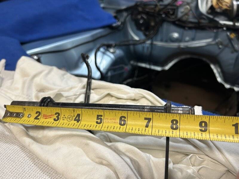

I just pulled mine. 727 column shift.
The z bar measures approx 8.5 inches end to end
If you have the correct parts, it helps to loosen the trans bracket for this bar to get it into place. These are the parts I used when converting from /6 to 340 / 727
