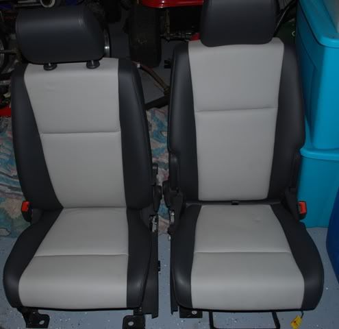

Since I am doing a resto mod i am puting seats from a 2010 dodge nitro inplace of the stock seat. the colors are charcol and tan. Just have to fab some seat brackets.

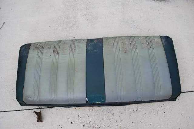

I picked up some rear seats the other day for a good deal. just have to have them wrapped with a matching leather.
