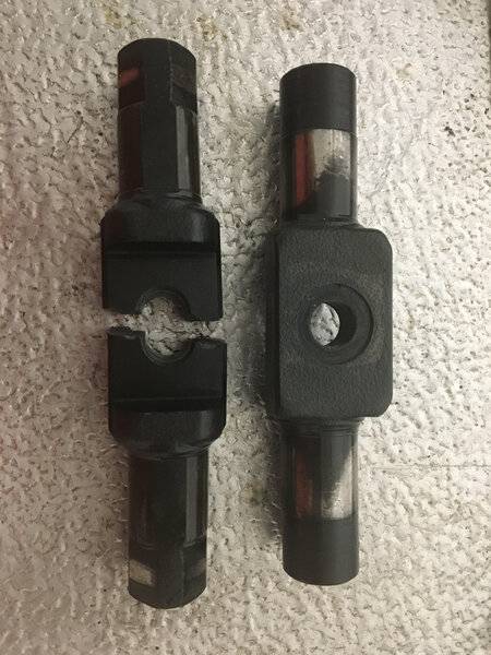

I'm rebuilding a 30 spline clutch-type Sure Grip from a 8 3/4 differential. One of my pinion shafts is broken. I have not been able to locate replacement parts. Doctor Diff sells a complete internal repair kit however, he out of stock.

I have one extra one. I don’t remember if it is drilled or not for the thrust button. I had the same issue as you. I found out that the Dana 44 uses the same cross shafts. I had one extra but I don’t remember if the one I have is drilled or not, I’ll have to look.
