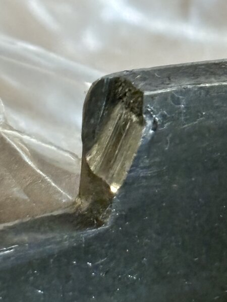

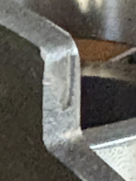

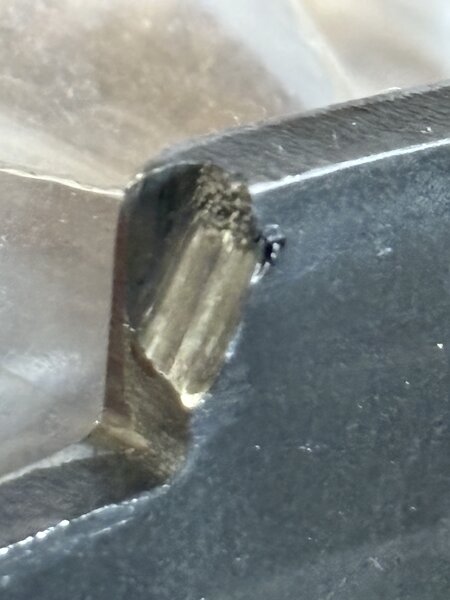

I have seen the Sunshells have a lot of wear around the perimeter
If there is enough clearance that might bang when it applies 2nd gear ?

Here are a few pics of wear on the sun shell I was speaking of .
I have several shells like this .
Two of the pics show a bad wear pattern,,,probably an 1/8 ,,maybe 3/16 or more deep .
The good pic is what the other side of the register looks like on the no load side .
That wear will add a lot of slop into the system.
It might be what you are hearing,,I’m not sure ?
Tommy
interesting, but what exactly is a sunshell on a transmission? Sorry if its a pretty common knowledge thing, I've just never heard that term. Either way though ill probably drop the valve body again soon, cause its been a fairly long time since I've dropped it. Also to answer your question of there being anything in the pan. There was just some super fine metal band material i think??? And one other time i dropped it to change a leaky gasket same band material and maybe 2-3 slightly bigger chunks of metal. Damage might be in the valve body i just have to look again soon when i get a chance.
The sun shell is a large shell,,,that the planetary,,,and the sun gear fit inside of .
The sun gear is splined to the sun shell .
Also ,,,,the front clutch is located inside and drives the planetary .
The planetary rides around in a circle inside and drives the output shaft when engaged .
Just like back in school with the explanation of the solar system .
All the planets,,,,(planetary ),,,,revolve around the sun,,( sun gear ) .
The sun shell simply keep them all housed in place .
And the direct drum drives off of the lugs ,,the pics showed .
That’s why there can be ,,sometimes,, a lot of wear on them ,,especially in a 904 .
This is an over simplification of the workings,,,,but a basic explanation of how it works .
