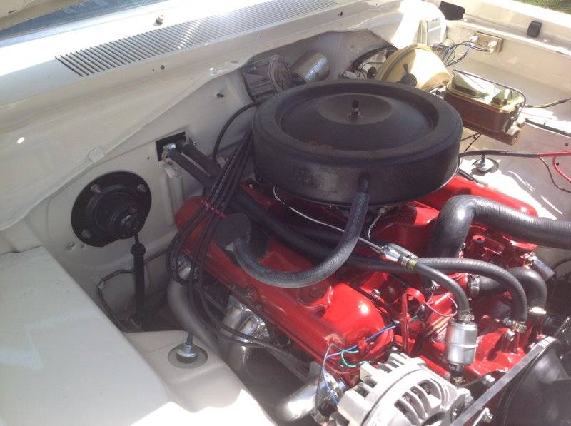

Can you say RoadRunner Wagon ?
GetAttachmentThumbnail
I bought this wagon in 1990 for the engine and was amazed
when I popped the hood !
Somebody put a RR Aircleaner on it !........ and the Holley Carb too ! ..... and the Exhaust manifolds !! And the 3.23 Suregrip !

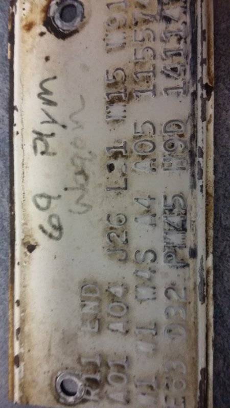

then I checked the VIN..... WOW... all factory... including a HD 727...
I was too stupid to save it.... but I kept all the good parts ! Air Cleaner is on my Fastback today..
That was not a clone.... It was ordered with a RR drivetrain...
Windage tray , correct intake , Carb and air cleaner ( currently on my Barracuda) , exhaust manifolds etc....still had foil packet below the intake.
Huh.... The pic dissapeared from my first post.... That's why you assumed it was a clone..
