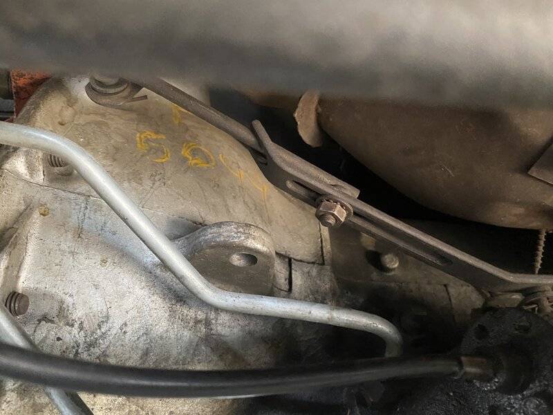

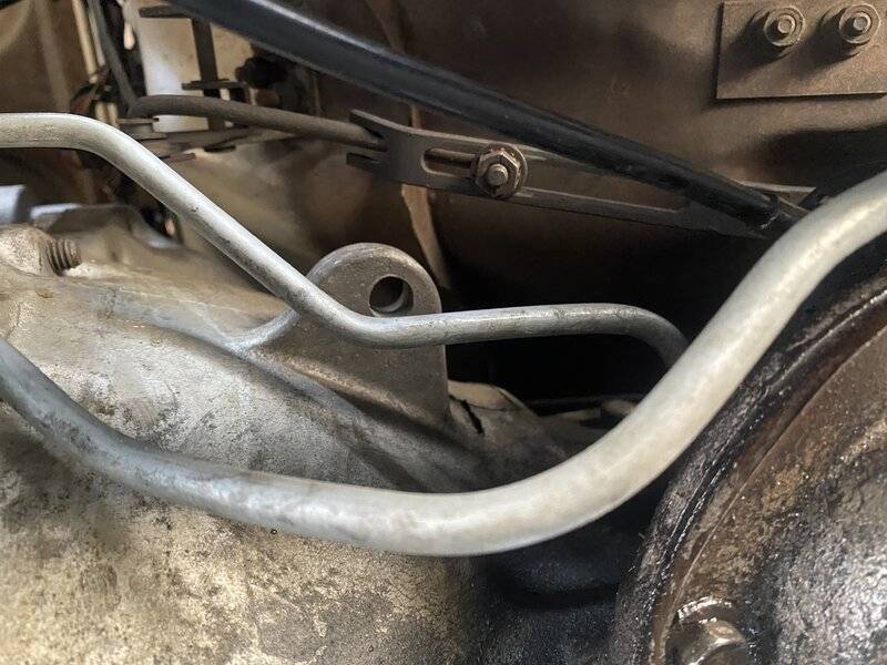

Anyone have pictures of the lock nut/transmission lever bracket on the driver side of the 904 push button trans? I suspect mine is out of place. My 1964 Valiant runs and goes through all the gears fine but doesn't kick down.
Do u have linkage to adjust for the kd? U have to mash the gas pedal all the way to the floor for it to kick down. Kim
I held the gas pedal down, adjusted the top rod that has threads.
