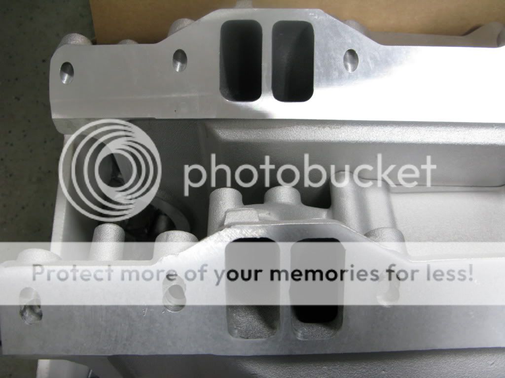

Well, I am trying to dig up pics for this, but am at work. Perhaps you got a good one and perhaps I got a bad one. All of my opinions are based on my experiences with one intake.

There are a lot of problems with the chinese intake. It is not a direct clone of the air gap as a superficial examination would indicate.
The runners and the plenum on the edelbrock are actually larger. Further, the runners on the Chinese have almost no taper at all. Comparing the shape of the runner in addition to the size, it becomes obvious that Edelbrock does theirs the way they do for a reason, and the Chinese are just throwing aluminum in a casting mold.
The ports on the intake I had were horrible. The opening sizes were radically different and they were not even aligned [EDIT}vertically!
I checked gasket alignment (these are the pics I am hunting). I did this by placing the gasket on the cylinder head, then installing the intake, torquing it in place, scribing the exposed portion of the gasket, removing the intake and placing the gasket against the intake while lining it up with the scribe marks.
The Edelbrocks were on the money for alignment when checked in this fashion. The Chinese was off badly. A couple of ports were much too high. Most notably the ports on one side at the rear were so misaligned that the divider between the ports was off horizontally about 1/16" - 1/8". Of course, this means there was precious little gasket available to separate the ports (hello vacuum leak), and that once installed there would be a significant amount of the divider blocking the intake tract.
This problem cannot be corrected with port matching!! Nevermind the fact of making it clear the people casting these are pure clown shoes.
Here's the only pic I can dig up at work. It is a comparison of the port on the Magnum air gap and the Pro Products.
There are a number of reasons why this is not a good photo and they are all my fault. the ports appear smaller than they are on the Eddy because it is further away.
Check out how the Edlebrock openings are uniform and parallel, vs. the PP. Also check the machining around the bolt holes. Sheesh!
Further, vertical port misalignment on the Pro Products is deemphasized by the viewing angle. the port on the left is much higher than the one on the right.

I gotchya. I knew you weren't blowin our skirt up. I musta got a decent one, because that's the first thing I did when I got it. Measure and inspect all the ports. They look good. Thanks for all the info on them. Without a doubt, I am certain you're right. Especially after seeing the comparison. Thanks.

LXGuy: I went and double checked my intake before I bolted it on tonight and it actually looks extremely good. Ports aligned straight and all are very symetrical. I musta got lucky.
X2, Stroker on the intake.The ports lined up nicely.Plenum was rough,so I dropped the plenum divider 1/2" and radiused and smoothed it all.
