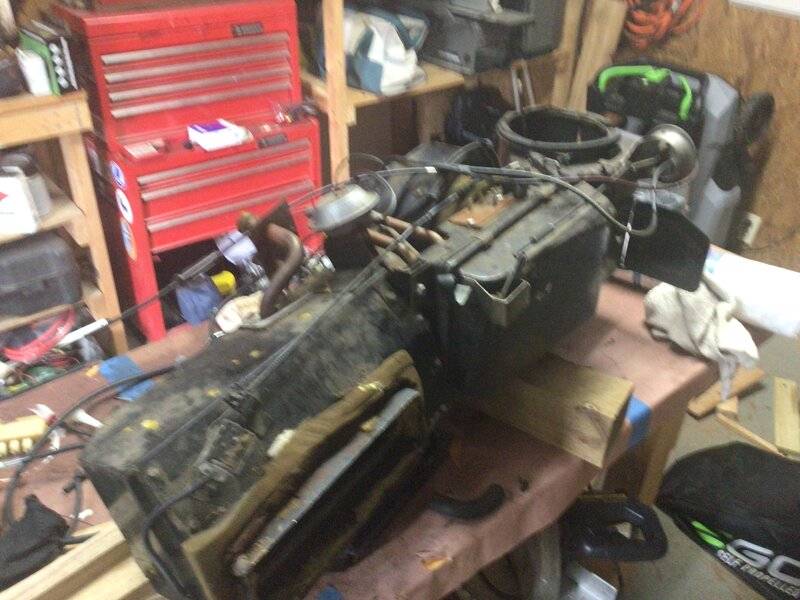

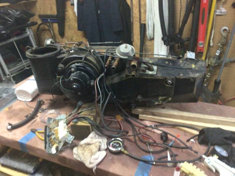

While sorting out an electrical issue I pulled out my non-working Air Conditioning system and heater box. After looking it over, it’s apparent that I have three options regarding heat and air conditioning with my car;
1) Restore the original factory air system including a new/rebuilt compressor, all lines, the under dash vacuum lines and actuators.
2) Remove the A/C system and go ‘heat only’ by replacing the heater box, control head and dash bezel
3) Do #2 above and add an aftermarket air conditioning system later.
My inclination is #1 but it’s going to be a long and involved process as I hunt for parts, get lines fabricated, etc. I live in Columbia, SC and A/C is nice but I can live without it. Furthermore, the factory A/C system is both a power and a potential vacuum drain on the slant six. (I’m assuming future vacuum leaks in the under dash controls)
Have any of you been down this road?

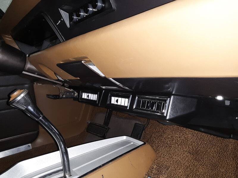

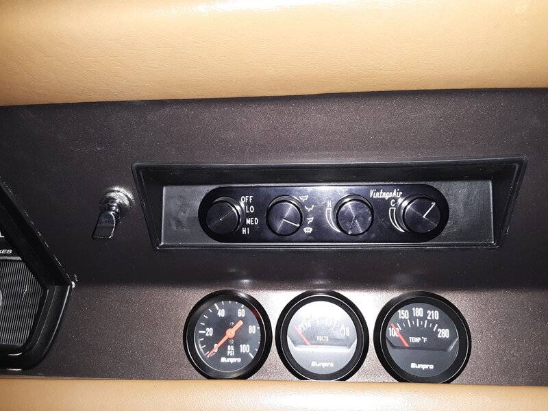

Yes I have. I refurbished the factory A/C and two months later if failed and needed to come out again. I opted for a Vintage air Mini that has both A/C and heat which took some adapting but it does a good job. The ducting was the most difficult and I took my old controller and adapted it with the help of JB weld. I have a console so an under dash unit wouldn't work for me.

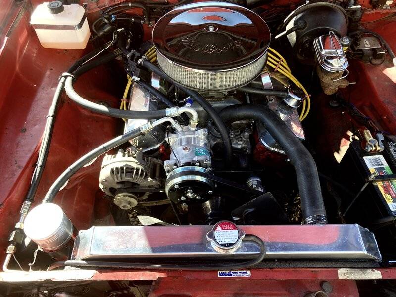

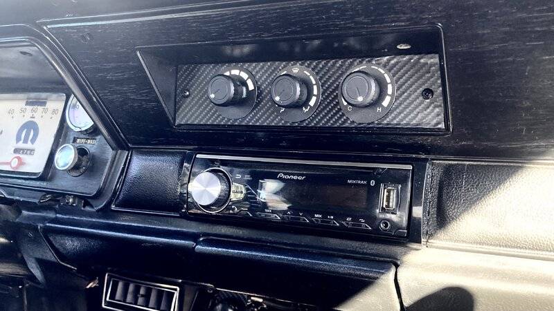

I pulled the entire heat only system and replaced it with a Classic Auto Air unit.

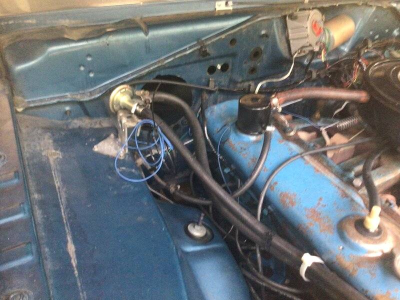

Block off all of the firewall holes and start over, and yes some wiring. They make kits for some cars but nothing for a factory A/C A-body car.

Thanks; did you use the blower motor hole in the firewall for the heat & A/C hose lines or did you plug that hole?
I put a factory air setup from another car in my non ac 69 Cuda because I didn’t want to spend $2k on aftermarket. The DMT rebuild kits are pretty cheap and work well. It just takes some time and patience to get it all working. I wanted to keep the factory look.
