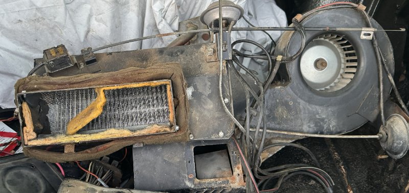

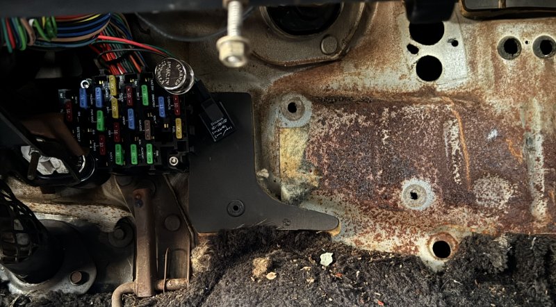

ok so i have a few pictures, sorry i had already remove the heat and air boxes from under dash. the problem is the evaporator is to long and sticks past the firewall opening just ever so slightly and therefor covers the new fuse panel. but as you can see the pin holes for lining up the air con evaporator on the insulation is really close, and the metal housing stick past the insulation, i was thinking i might have enough room to move the bulkhead connector over to the driver side as far as i could and maybe make some room for the unit to go back in. i am not sure if this unit works, leaks, clogged or anything about it. i assume it wasn't working for some reason and that's why there are several pieces of the air con side missing
that all being said i am just going to try to get a after market heat/ac system, it might clean up underneath the dash a little

As post #7 says, these reach around do it yourself harnesses, are not for everyone, and regretfully, you just found out why. Reach around meaning avoiding buying an orginal replacement. M&H orginal replacement harnesses in all 3 of my cars. One is an A/C car , just like yours. The fuse box is supposed to be somewhere else, not at the bulkhead connector. Sorry that this isn't what you want to hear, especially after spending good money on your reach around.
Yes, you can buy an aftermarket A/C heat system, but, they are for a car w/o A/C. Your firewall is different, but it can be done. No free lunch. Your old system can be rebuilt, but hard telling what you have and don't have. Kind of a can of worms your in.
