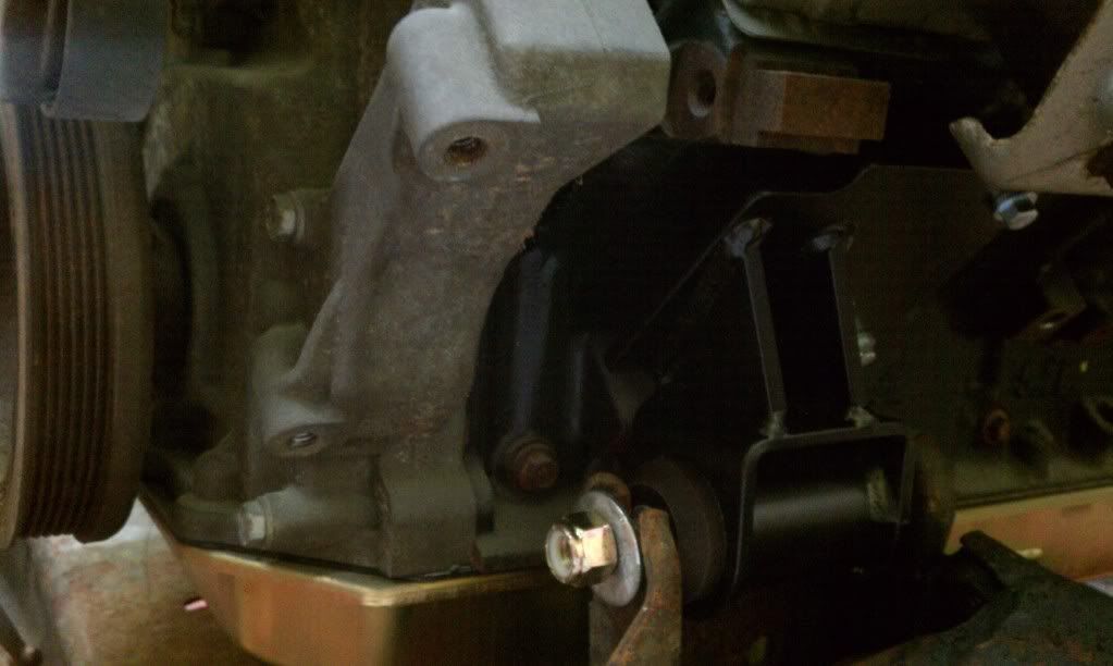

Did a test fit of the 5.7 into the K-frame tonight, and noticed it was impossible for the A/C compressor to fit with the motor mount right there. I have an 05' LX motor. I know the truck compressors mount up high, but I would really rather not switch to a truck intake and timing cover, and or build spacers for my current car intake...anyone looked into this?

Took a look at a 300 compressor today, and it looks very short. I need to get one from a local junkyard and see where it hits...worst comes to worst, I make a new motor mount for that side.
Compressor is too long by about 3-4 inches. I want to keep the stock location for it, so I moved the motor mount to the rear 2 holes, and I'll probably be modding the K-frame to move it back to match the mount in that location. After moving the mount back, plenty of clearance for the A/C compressor and lines.
I fabbed my own after experiencing the same problem with the TTI conversion mounts. I was even able to keep the oil filter in the stock location.
Looks like exactly what I had in mind. I'm still a fan of the relocation kit so when I take the oil filter off, it doesn't dump oil all down the K-frame in general...was never a fan of that on the 440 Challenger we have...
