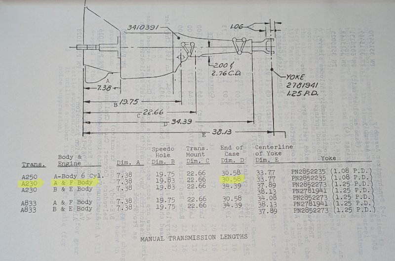

The 30.58" is for the short extension on the A-body (or F-body) transmission. The following image shows the manual transmission dimensions from Chrysler:
Just remeasured and I got a long ext (34.4 for dim D). I was measuring from the front of the trans, not the bell housing and if i do some math I can see the 27.x I was getting. Mystery solved.
Now I'm not sure which rear seal to buy again. The Timken 7300S is listed as applicable to the "A230, 30 spline, short shaft." Just looking at the pics, there is a "8160" style that looks different than what I have and they all say for 23 splines so I must not have that. Then there's a "long boot" style which both look what I have with a long rubber boot sticking out tail. It looks like the 2506 is for 26 splines and the 7300 is for 30 splines. Is that the number of splines on the driveshaft interface? Is there a way to tell what I have without pulling the driveshaft and counting?
34.4" indicates the long extension shaft transmission for B- or E- bodies, or trucks/vans. This length is the same as the A727 automatic transmission and the long extension shaft A833 4-speed transmission. All of these with a slip yoke employ the same output shaft seal and have 30 splines on the output shaft. The spline count is for the engagement of the output shaft to the slip yoke.
The original Chrysler seal part number is 2400300, which is a booted seal. Part number 2400300 crosses to Timken 7300S.
The booted seal and non-booted seal for the same transmission have the same yoke to transmission sealing surfaces. The boot is a dust seal/protection for the area of the yoke that moves in and out of the main seal. The booted version is preferred, but if not available, the non-booted seal works for the primary function.
