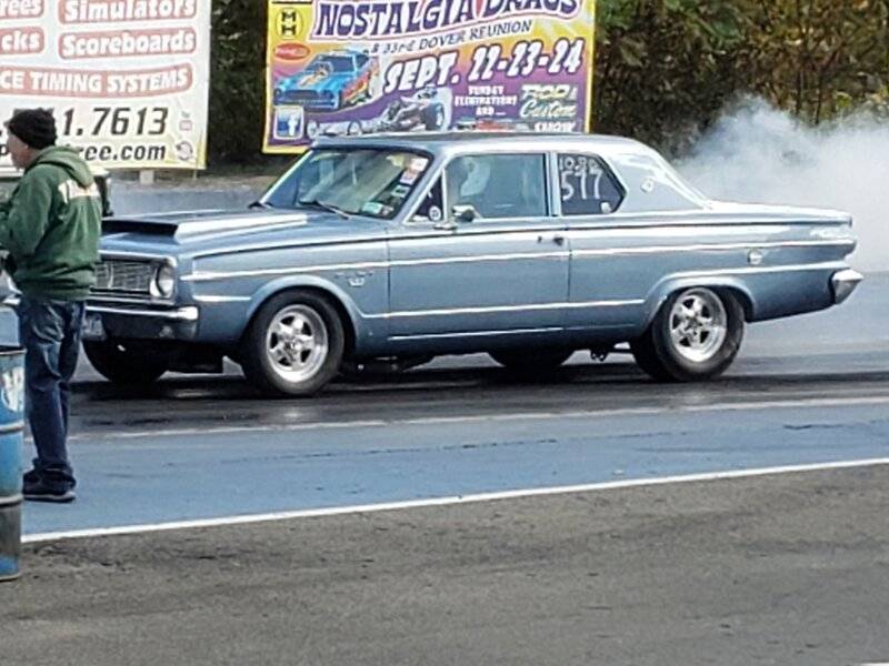

A few pics of my Demon.
Beautiful Demon, always wanted one, but I have had my 66 Dart for 26 years now and really can see replacing it after all these years, It's been a faithful friend for what I have put it through.
