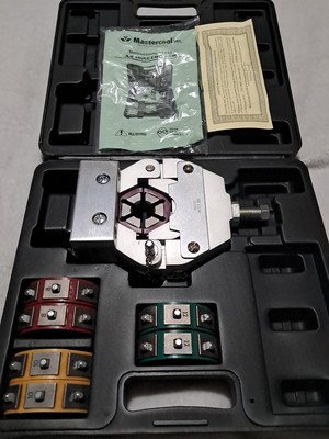

I got lucky and nabbed a used Mastercool 71550 manual crimper on facebook for the price of one of the new knockoff copy cats and I'm very happy with it.

On these manual units, I assume it's a good idea to put grease or antiseize on the big bolt that you tighten down. All of the videos that I've seen, it looks like their threads are dry. Do the manual and pump up units both give equal crimps? And on the manual units on the videos I've watched, it looks like the frameworks are really loose?
I didn't use any grease. Just tightened until the jaws came together and made contact. No need to try and go any further than that. The framework is loose but once the dies make contact with the fitting, it all tightens up. I'm the 3rd owner of the one I bought and you can't even tell that it's been used at all.
