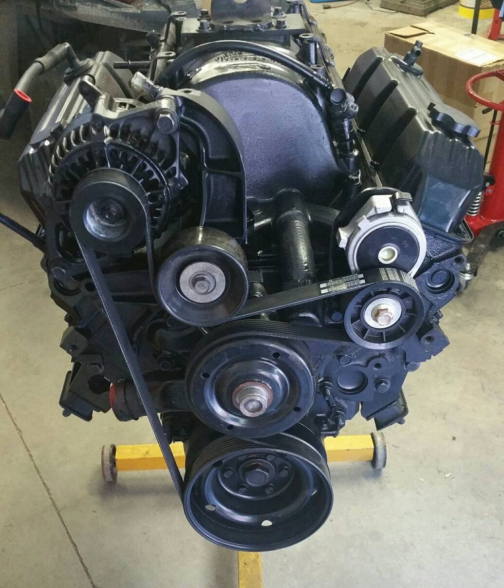

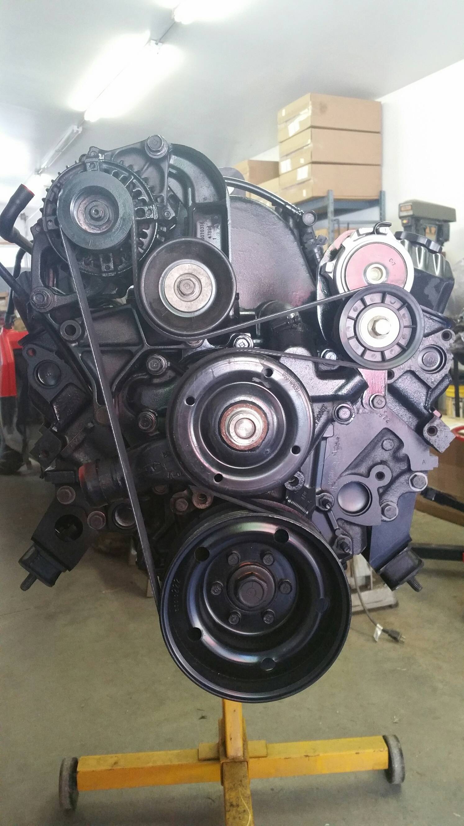

In the process of installing these magnums in non AC/PS cars while still using superior serpentine belt system we quickly realized the need for a better solution other than ugly Dorman AC compressor delete pulley. Here is our solution, which will be available after a bit of road testing, some CNC code writing and some water jet table time. They should be available for sale by mid summer, made in USA and come with bracket, tentioner and belt. This is assuming anybody even wants one. So now is the chance to share your opinions. We all know you super shy FABO guys have problems sharing your opinion with others.:lol:
Comments like "thats awesome, I want one", "Gross, that looks like Yugo poop", "I will never run anything but a V belt" or "Why would I buy that from you when I can make one in 4-6 hours" will be gladly accepted without fear of tire slashing retaliation....just need to figure out if I should send it out to CAD or not. Your input is greatly appreciated.
With a little CNC action it'll look OEM. Maybe shape the bracket more like a figure eight...give it a waist?

What's the round thing between your bracket and the pulley? The tensioner?

We could do fancy aluminum billet piece but not sure if it would sell for price needed to cover billet cost. We are trying to keep it inexpensive. The tentioner on stock system w AC and PS its on pass side by coil. I purposely didnt paint tentioner so you could see it. Its pretty easy to ditch PS if keeping AC.

I like it. Is it a stock tensioner, to keep the cost down?

Yea, stock tensioner turned upside down. Tried idler but didnt like how it worked out. We are planning on keeping it low buck, factory available part. Target price bracket w new tensioner and USA made belt $100-$125. Probably sell bracket by itself for $45-$49. We will see as it gets a lot cheaper if you make 150 rather than 30 units. Water jet time aint cheap!

Its not for performance, its for A bodies that dont have AC or PS and to eliminate a bunch of bulky parts you are not using. I have 5 A's we are currently building and only 1 has PS and its not getting AC as its a vert.

Its not tough to delete PS while retaining AC, its tough to delete both. You oculd just replace PS with idler. If we got more response to either, we would make it but so far we may just make them in house for our cars. Cant justify expense of CNC code and water jet time for 10 brackets.
