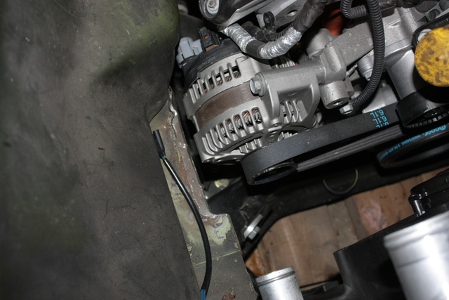

Using this pic I found...
attachment.php
How much trimming is done for this? Can anyone give me a measurement? I'm gonna trim it out while I'm working on the engine bay.
Riddler
If I remember correctly it had been posted before that just trimming back the flange to the frame rail itself was sufficient.
I trimmed the overhang only as well. Clears, just barely. The plastic aroun the stud is touching the fender though. 73 duster.
