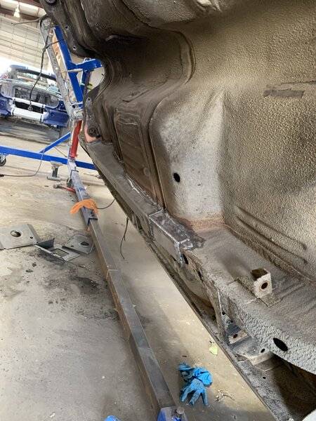

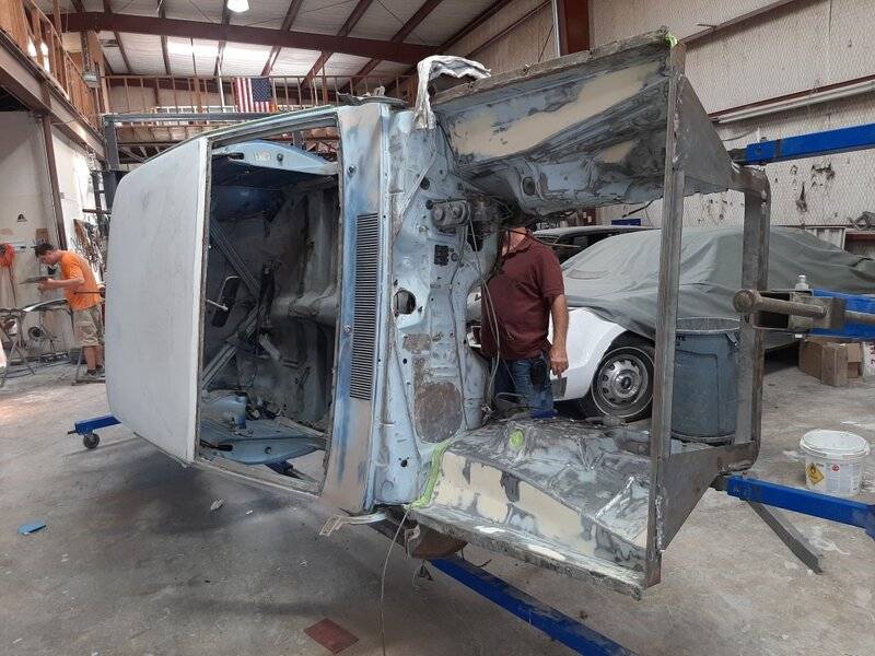

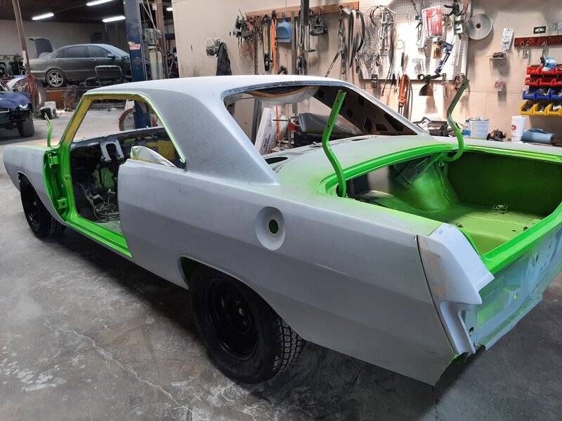

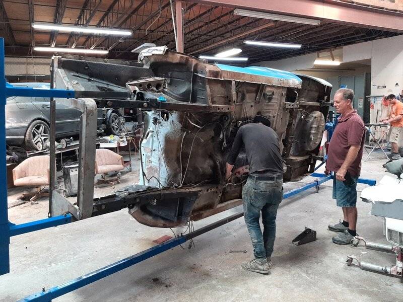

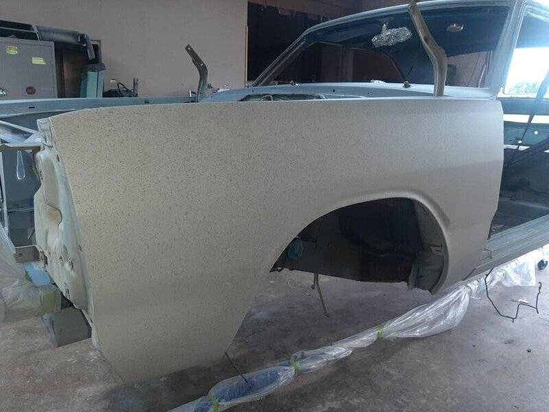

Well all but the rear shackle mounts are finished on the USCT frame kit..

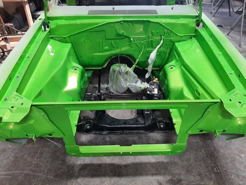

Frame connectors, front radiator support, shock reinforcements, torque boxes at all 4 corners

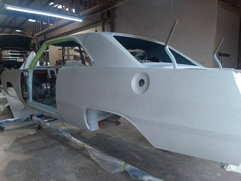

Flip top gas cap recess has been grafted in, mini tubs are in progress, all of the floor and fender bracing has been fully welded.

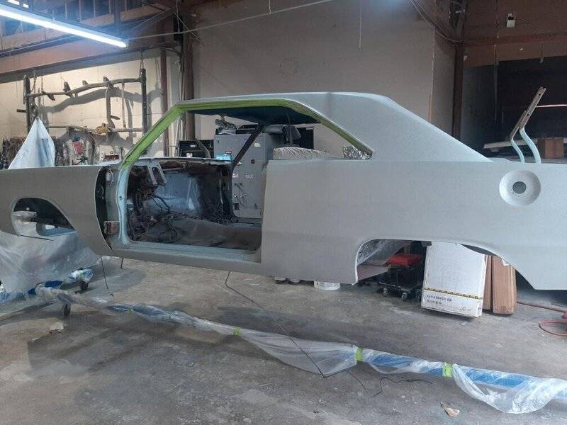

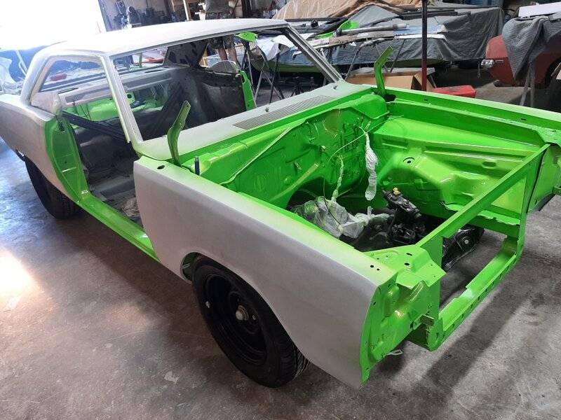

Body work is getting ready to get a polyester glaze and some additional block sanding.

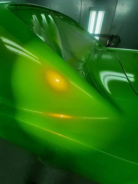

Body has first coat of poly getting ready to block sand and prep for another coat

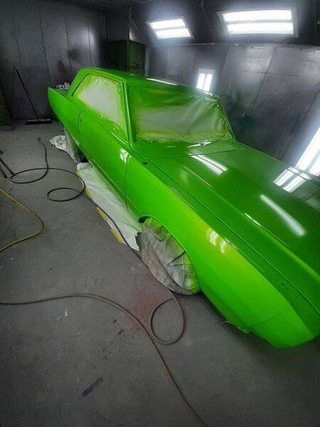

Nice color.

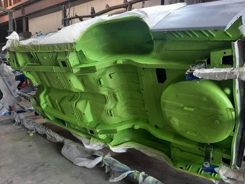

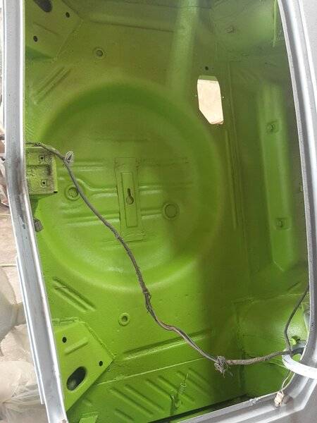

We decided to apply a bed liner with color mixed in on the underside and trunk. The mini Tubs opens up the rear wheel wells nicely
Wow I'm impressed how they are moving along very quickly and the quality of work so far looks to be amazing!
