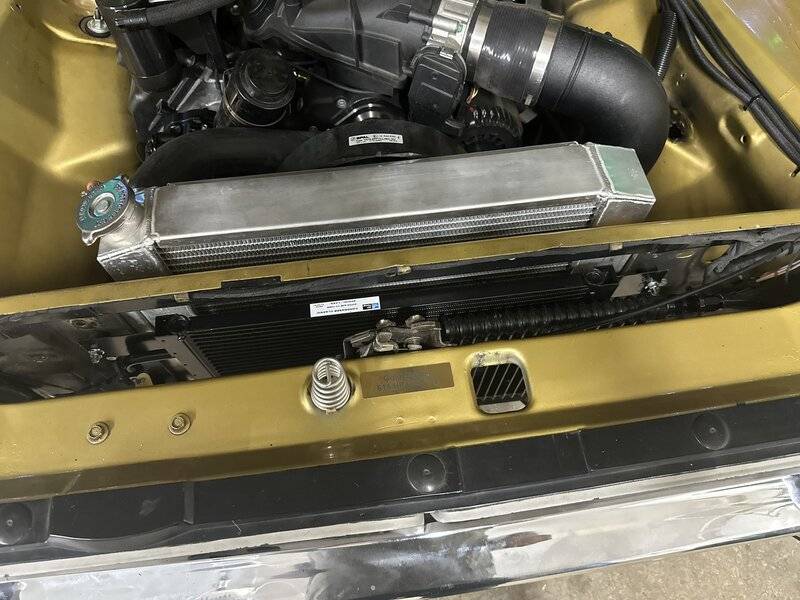

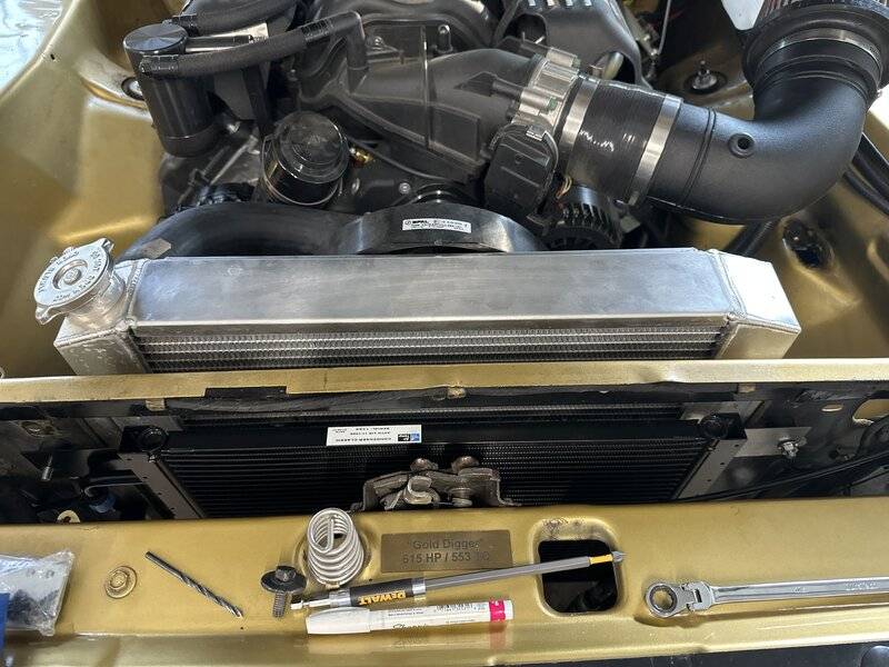

The instructions all imply that you'll use pre-existing bolt holes / mount points on one side, and you'll pinch the mount between the radiator ear and the core support? The problem with this approach is the screws that attach the bracketry to the back of the condenser would be in direct contact with the radiator tanks and would eventually rub through the metal.
So it's time to re-engineer the "direct fit" kit.
This is one of the mounting holes that they want you to use - There's several other options I found which were unused.
Using rubber isolators, I moved the mounting point from the engine side of the core support to the grille side.
I ended up drilling a few extra holes in the radiator "ears" so I could pass the isolator bolts through and secure them.
I had to make two new mounts for the driver's side. The passenger side mounts were the appropriate length, but I have no idea what they intended for my particular core support. I made them out a flat sheet of cold rolled steel that I cut and drilled the holes to match. Then I used high temp black paint to pretty up the brackets.
And here's the final install. I moved the transmission cooler to a zip-tie style mount through the condenser. The issues now are - the provided hard lines which were supposed to pass through the firewall will require some re-work. The A/C shop is planning on doing some cutting, bending and welding to resolve the angles. I chose to leave the dryer install up to them along with the lines so they can shorten and place it correctly.

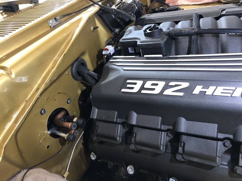

@GoldSwinger71, how did your box fit on the firewall? I mocked up the lines today to see what orientation of fittings I'm going to need and suffice to say I hope I never have a problem with my #8 coil pack or spark plugs as I'm not sure if I'm ever going to be able to change them again without pulling the A/C line every time.

Looks like your engine is slightly further forward than mine, but maybe it's just the angle of the picture. There's a chance I might be able to get the coil pack off, but I'll definitely have to put some pressure on the lines to do it. I took it off today to pull the valve cover to look at something and I could squeeze it out past the tube coming through the firewall, but the fitting is going to add to that fun for sure. Mocked up the lines at least at it should be straightforward enough. Hopefully I'm not further reducing whatever limited ability I have to work on things. It's not like this engine was designed to go in the car, it just technically "fits" from a physical standpoint. There are things I probably would have done differently if I was doing everything from a clean sheet with all the parts already in hand, but my car has been an evolution since day 1, so it is what it is and I'm okay with that.
