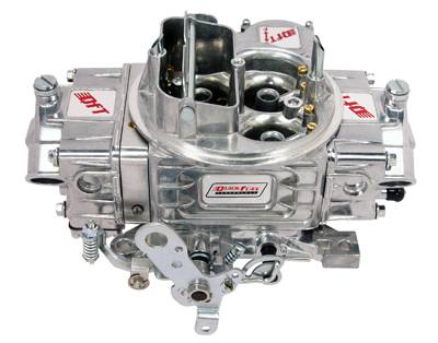

I inherited this carburetor on the engine of the truck that I just bought... It looks relatively new... I'm going to sell it but I don't know what to put in the ad like how many CFM and so forth... I searched it over and over and could only find this one number 4508037..
It's a quick fuel technologies...
I appreciate anybody's help and experience... Thank you..
Sounds like 600 cfm vac sec from the bore sizes. It doesn't have a secondary metering block, only a plate, so it wouldn't be a 'performance' model.
Found this on their website

Yuppers, that looks like it?..
THANK you...
I measured it with my Harbor Freight digital caliper...
The venturi diameter is 1.56??? I'm referring to the tight area around the booster midway down the venturi where it necks down. Are you able to get a measurement of that diameter?
