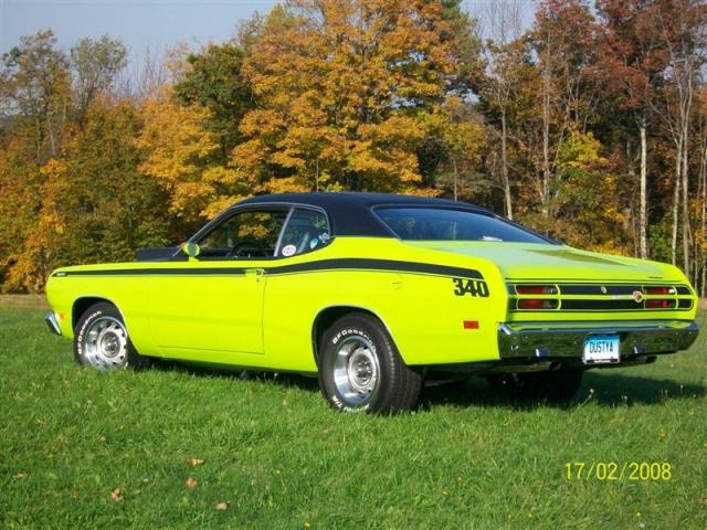

Here is what I'm running-
Stock 8 3/4 A body rear
Cooper Cobra 275/60R15
Crager SS 15x8 4.25" backspace
Espo +1" leaf springs
3/8" clearance to springs in stock location.
Get a slight rub occasionally, with multiple passengers, heavy duty bumps, and steep driveway entrances, but don't see any witness marks on tires, wheel wells or springs, so don't know where they rub.
Fronts are 14x7 Crager SS 4.125 backspace with Cooper Cobra 225/70R14

I do not know that measurement off hand, but I have a stock 8 3/4 A body rear end. If both you guys have 3/8 to 1/2 inch of cleareance from the leaf springs, that should be plenty. Thats about what I have as well, but I have never had any rubbing. I would have to look else where for somthing making that noise, ( rubbing sound) Maybe you are rubbing the wheel tub itself with passengers in the car. Your car probably sits a bit lower than mine, as I have superstock springs installed.
More of a bump than a rubbing sound, could very well be the pinion snubber.
Really not a big deal and no visible wear on the tires,so I haven't tried too hard to chase it down.
I would think an 8 3/4 and 8 1/4 for an A Body would be the same length drum to drum but it wouldn't hurt to confirm that.
To the OP- I searched and started multiple threads trying to get an answer, so I know the feeling. Lots of people said 275's fit their Dusters, then went on to add that they had non-stock axles, relocated springs, or custom backspaced wheels. :banghead:
Seemed like I couldn't get a straight answer.I finally just got on Summit for exact tire specs, did the math, and took the leap.
well like I said, my rear is stock, with stock small bolt axels, and no spacers, and 275's fit just fine as you can see. Ya, it could very well be your pinion snubber. Is it an adjustable one, or a stock one ? thats a great looking duster by the way !!!
