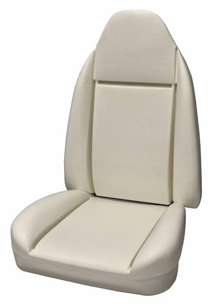

One year only foam. Not the same as 70 Challenger, but the frames are the same. I got mine from PG Classics 3 years ago, but I don't see them on their site now. here a picture of what I think you need:

Legendary confirmed that no foams are available from them and that my 70 Challenger foams will be close so I’m going to give it a shot.
