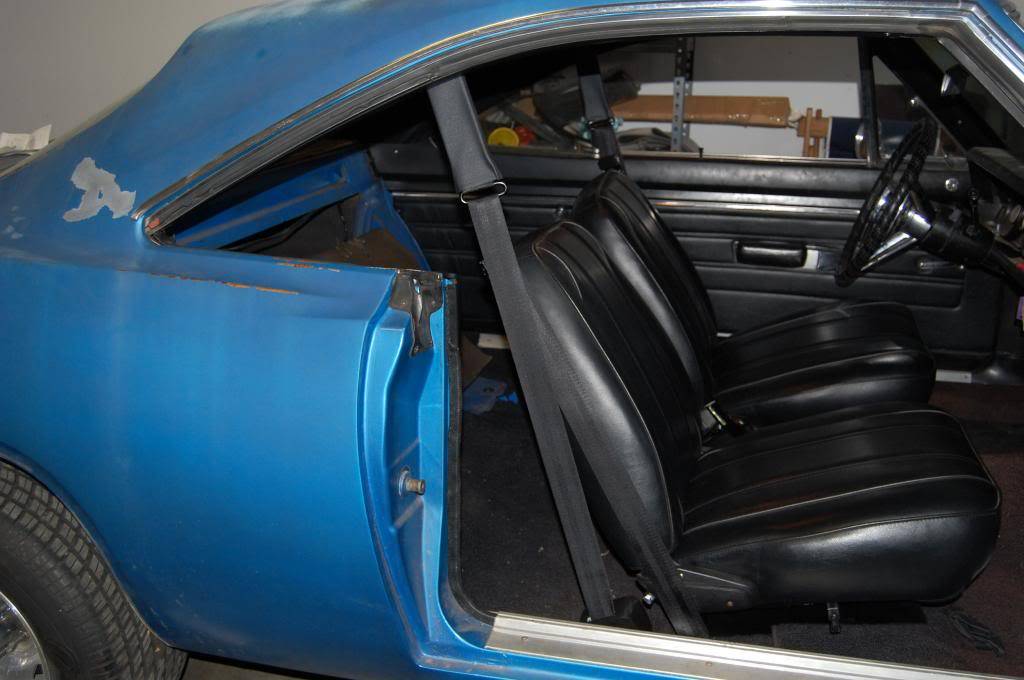

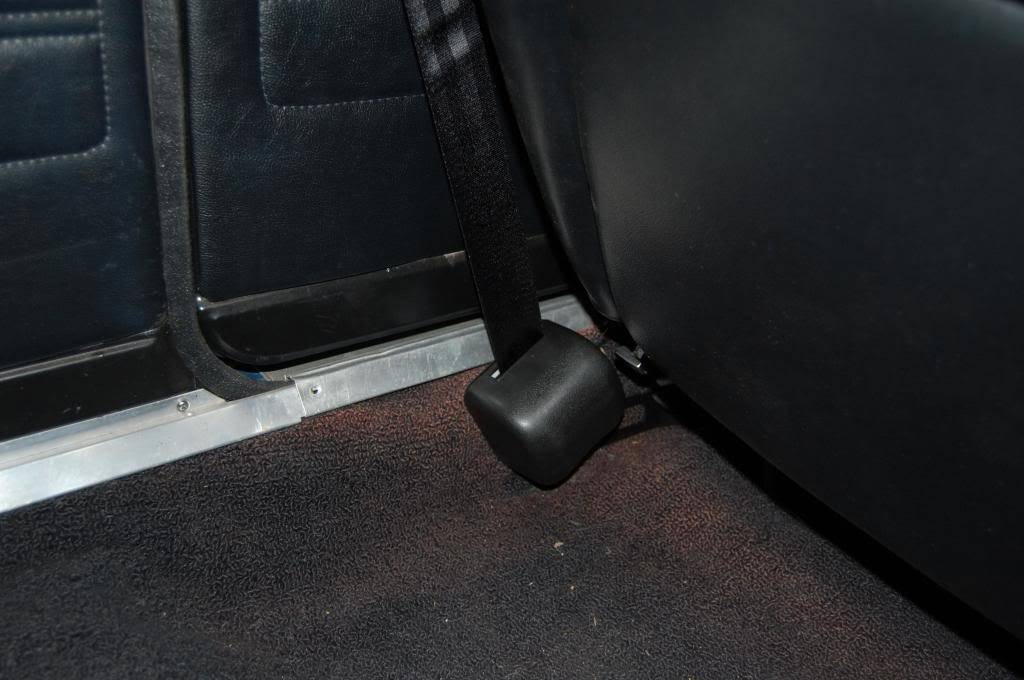

Pix in car, are another fabo members vehicle, similar belts. This is how i will set mine up.
Hope this helps
Hope this helps

Moparmat. Do u remember what car the blue one is? Did u have to modify anything to install the set? The picture looks like the roof rail point is further back than the retractor. I have a 71demon and a set of mx three point belts I want to install. I am getting conflicting info as to whether or not I am going to have to pattern different attaching sites. The retractor is large at the floor but the the roof rail attach point is more than six inches farther back than the floor point. It’s a bench seat car.
Thanks,
Al Graham.
Please see my thread about Wesco performance seat belts I bought in the body section I believe it will detail my install a lot better. The blue car which is not mine is also a barracuda notchback I have a 67 notchback in a 69 notchback if your car already has a shoulder belt attached point in the roof you only have to add 2 attach points in the floor the pictures on my thread detail that better as far as making an attached point and where to put it
