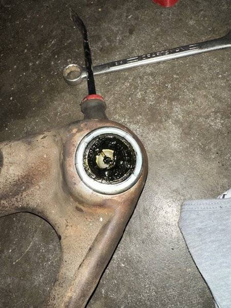

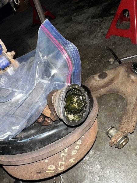

I don’t like the SBP stuff. It was designed for a smaller/lighter/more narrow commuter cars. I know the pics aren’t really related to your question but just to illustrate my point. The SBP stuff is just small, and I’d be worried personally to remove any material from the puny LBJ/knuckle.
If you want to drive it like it should be driven, it’s worth the upgrade to the BBP brakes/knuckle/steering components. I’ve got the 11.75” kit from @DoctorDiff and it’s the best value out there. You won’t be disappointed and Cass has customer service on lock down.
