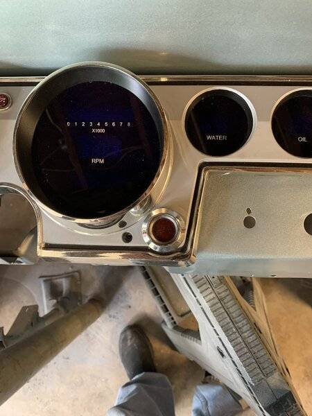

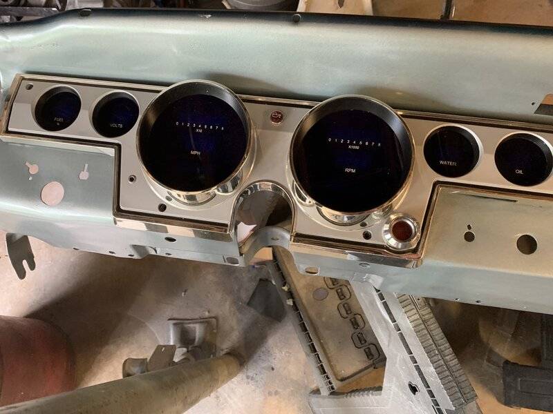

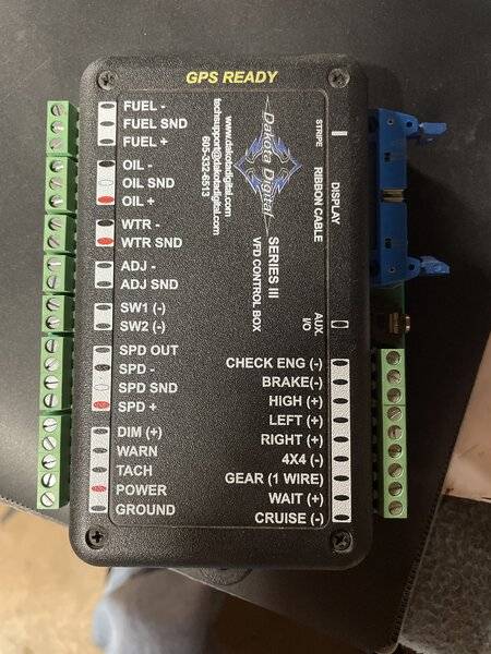

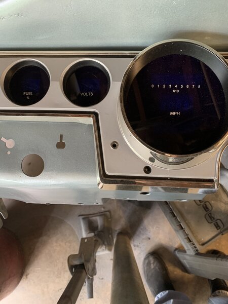

I have a 65 Dart wagon with a lot of modifications. The 65 Dart dash has no provision for an oil pressure gauge so I wanted to address that. I found a 66 Barracuda complete dash in a junkyard, so knowing that if I swapped the dash frame into my Dart, I could have my oil pressure gauge and a “Performance Gauge” or find a tach. Bonus - it had a complete factory AC in the cluster. From there it morphed into a Dakota Digital digital conversion. I sent the restored cluster to them and got back my converted dash. Gauges now included gas, oil pressure, water temp, voltmeter, speedo snd tach in the same spaces as on the original cluster This conversion also allows a user to add up to 16 different functions with add-on modules. I am still sorting out my custom wiring and need to install the wiring to the main Dakota Digital module

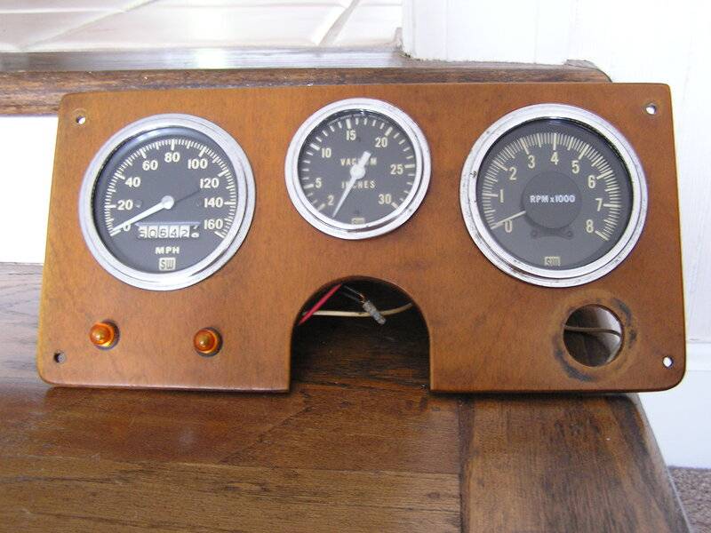

Since they are flat, it is easy to make a custom dash. 1/8 inch aluminum plate, or 1/4 inch birch or oak plywood and couple hole saws and some new or used gages. Here is a custom dash from my 64 Barracuda.
