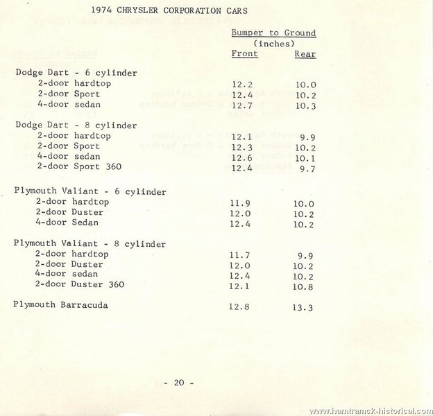

For a '74 A-body most of the specs are here (note this is for '74 so the Barracuda spec is E-body)

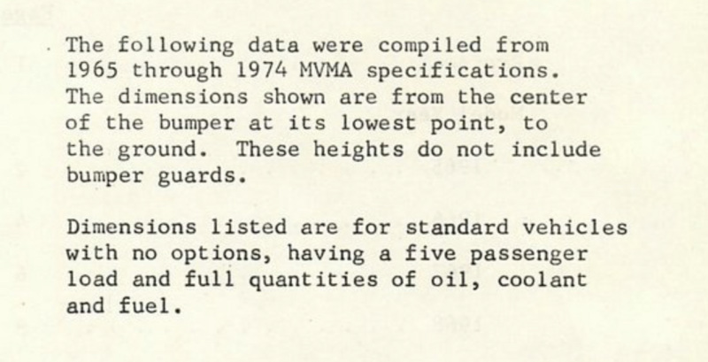

That height comes with the following conditions on how the car was loaded when it was measured
