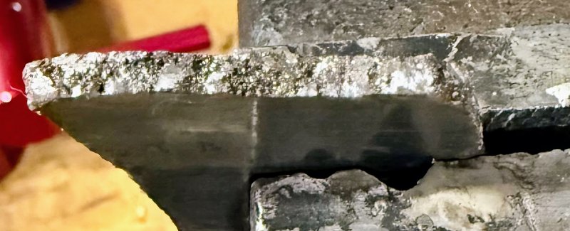

Been some talk lately about boring 340 blocks and how much over, i have a picture

This is a piece of a 340 cylinder that is .040 over, its .145 thick. i think another .020 or more is not going to make a dent in amount of materiel here, its very unfortunate that i have this piece.
What year block? My former machinist had to use 1970 and earlier castings to pass sonic test on all eight holes for a .60 overbore. But all of the early 340 blocks I’ve seen have cylinder walls like early 360 blocks with the cylinder walls at the core plug holes almost touching each other.
The problem is that not every cylinder in the block has the same thickness walls, and even within a cylinder the wall thickness isn’t necessarily uniform.
So having that one section at .145” doesn’t mean that you’ve got .145” in every part of every cylinder.
And it’s not even just an early vs late casting thing, it varies from block to block. The only way to be sure is to sonic test the block you’ve got.
I guess I'm in the minority. I don't think it looks all that good. Look at how much porosity it has in that casting. It's sure not very dense. Look at all those pockets. That's not good, regardless of how thick it is. Thanks for posting this. This seems to possibly prove the theory that casting quality got better through the years.
