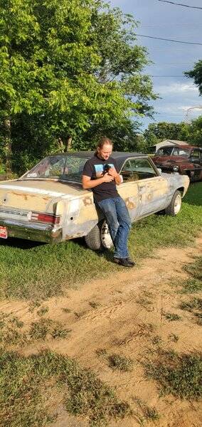

I recently got my car running and driving. It's a 1974 Plymouth Scamp with a stock head 400 and 727 swapped into it. The rear end is a Ford 9inch with an iron center section. The car has no interior, trunk mounted battery and fuel cell. It only has one seat, and no roll bar yet. The front bumper has been removed. It was weighed with 5 gallons of gas in the tank. The car weighed 2860.

That's a good weight for that car!
I hope my 70 weighs somewhere around 3k when it's all done.
Just FYI I have a mild steel 12 point cage and 2×3 × .125 thick frame tying my frame and cage together it was about 260 pounds

I plan to splurge and get a chromoly roll bar for mine. I'll pay the premium for the lighter cage.

If you're holdin a cat, you might be ok.
I’d kill for mine to weigh that…..I’m at 3045 without the trained monkey. How did you weigh it? Track scales? Own scales? Truck scales?
I weighed it at the local scrap yard. The last car I weighed there showed 3340 on their scales and 3295 at the drag strip. They're scales usually weigh a little heavy, but they're two miles away and good for comparisons.
