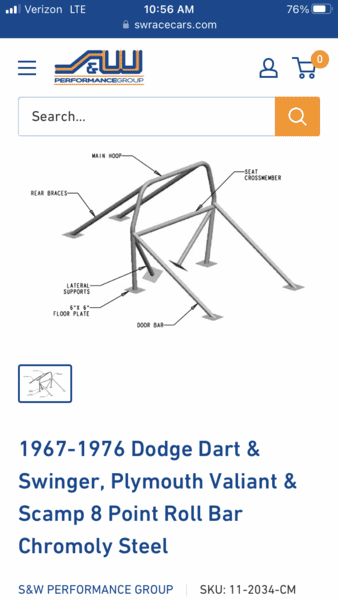

The S&W 8.5 CM kit with plates and welding rods weighs 84lbs. I got the swing door kit, so deduct -3lbs from that if you go with a solid door bar.

I added 2 extra downbars above where my anti-roll bar is mounted. I also X-braced the 2 rear downbars since they were longer. The thought process was to add as much rigidity as possible. The stock kit from S&W is 84lbs. With all of my extra bars/plates, it was 96lbs. Still not bad.
