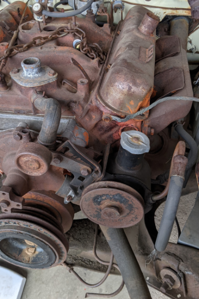

That stack looks just like the stack in pulled off a 66 383.
757
Does yours have that rubber-ish ring?
I don't recall but my photo it doesn't look like it. But... I do recall a 68 318 AC and PS did.
Or those 4 not fully drilled holes on the edge
Those are holes made to balance the assy, so each one will be slightly different in number or depth
