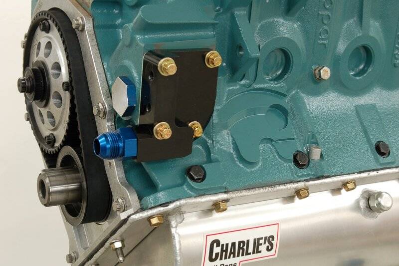

If you use a belt drive distributor with dry sump then you don't need a drive shaft at all. If you use a belt drive distributor with a wet sump then you need a support block to keep the gear from back up out of there. I've run all of these combinations. My 514 was dry sump, belt drive distributor, and EFI. Lots of fab work on that one! Here is a video:
Here is a billet block off plate with an AN fitting. Dry sump pan is also billet. That pan cost a little bit to make!

Belt driven pump with a wet sump also requires a block off plate for the oil entry. You can use the same block off plate as you would for a dry sump. This setup from Peterson is pretty slick. It has a vacuum pump that hangs on the rear of the oil pump so the belt drives both at the same time. This combo used a Moroso dragster pan with a #20 AN hose to the pump. Worked great on the dyno, never used it in a car.

I had a piece of 1/2 inch 6061 that I cut out with a jig saw and drilled some holes, just need to get a few AN fittings for my plate and pan.
