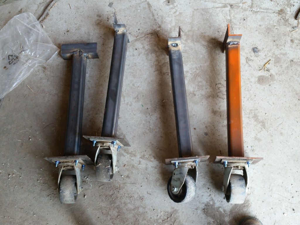

We built rollers for my dart.. The fronts bolted to the bumper bracket holes and the tears bolted to the front spring hanger. They were all built with scrap metal and got some dollies.. Ony thing I would do different is powdercoat them and get a lite stronger wheels as one is in the progress of falling apart now. You can see pictures in my build thread or here's one now you might be able to make out part of it... Good luck
