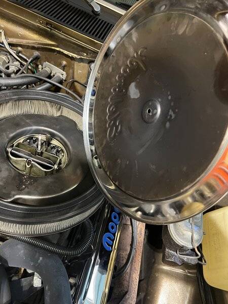

Bought my first mopar 73’ Duster and the bottom of the air filter pan is black (right above the carb). Any tips on how the 4bbl should be adjusted

So I bought a 73’ Gold Duster. I believe it’s a 318 4bbl (still trying to confirm it’s not a 340 because it was cloned to look like it). I noticed that the air cleaner was scalding hot after it had been sitting for about 15 minutes and took some pictures. From a Reddit forum it looks like I should check the timing and tune the carb. Both things I’ve never done before.

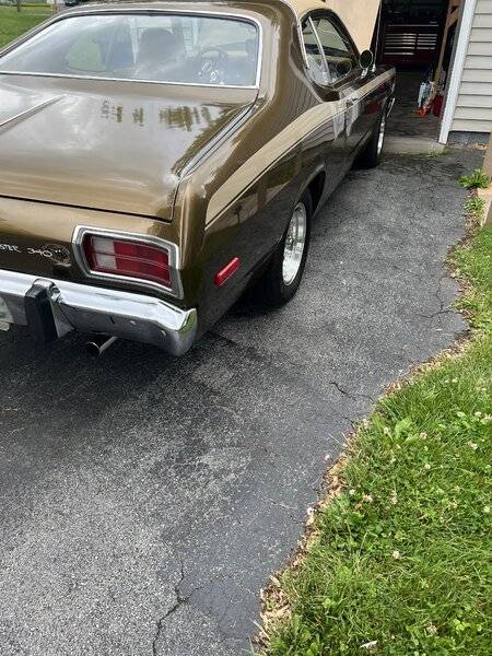

I should've browsed this forum more because the engine block number was extremely easy to find. It's a 318. The original owner looks to have put a few factory 340 stickers in the engine bay and removed the Duster emblem in the rear to replace with a 340 twister sticker. Looks to be numbers matching for a Gold Duster except the 4bbl carb and Edlebrock manifold. Also opted to remove the bench seat and put Bucket seats in. It sounds great but it doesn't quite sound cammed to me (though it very well could be).

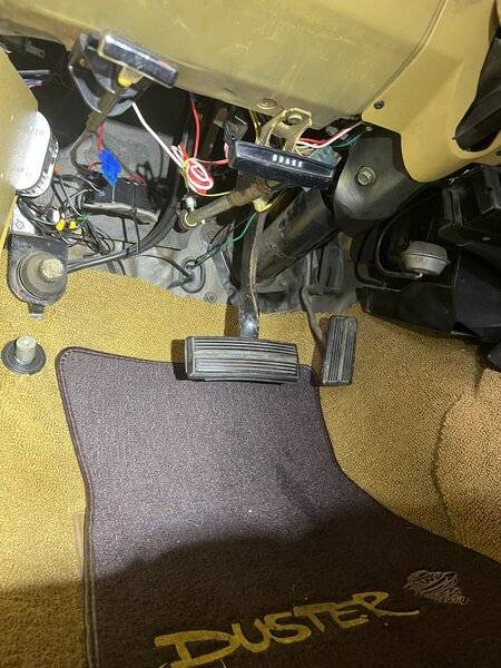

I'm going through the plugs this weekend. Didn't notice any smoke or issues yet. Drove it for about 45 minutes. It is an automatic. It was converted from the column to the floor (they saved all the parts). When I went over to test drive it the first time the tumbler in the ignition locked up. He had it towed to a local performance shop and I believe they put a whole new ignition in but I need to doublecheck the bill.

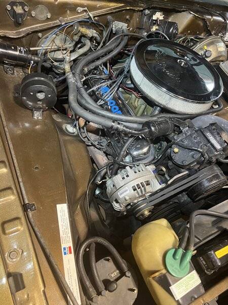

Thank you both! I took a few more pictures of the engine and interior. It’s raining where I am so once it stops I’ll pull it out of the garage and take some full shots of it. Currently just barely fits in the garage because I hadn’t planned on getting another car anytime soon but just kind of fell in my lap. Not sure what that wiring mess is under the steering wheel yet but it has led light strips outlining the bottom of the car so I figure that’s it.

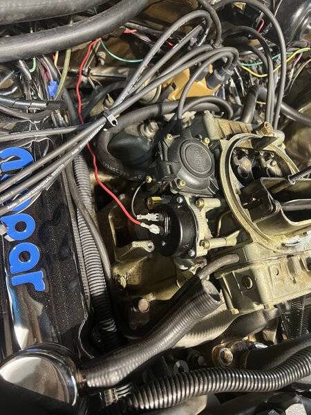

Alright so had some more time today and bought an infrared heat gun. The Block never got above 190 degrees but the top coolant hose also never felt full (it was hot, 125 degrees but I could squeeze it, I guess I thought it would be so full of coolant I couldn’t squeeze it)

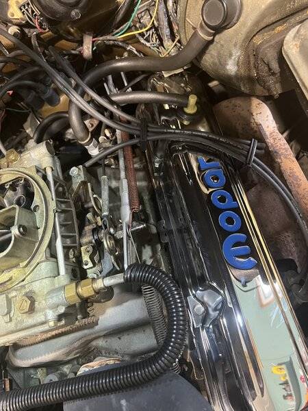

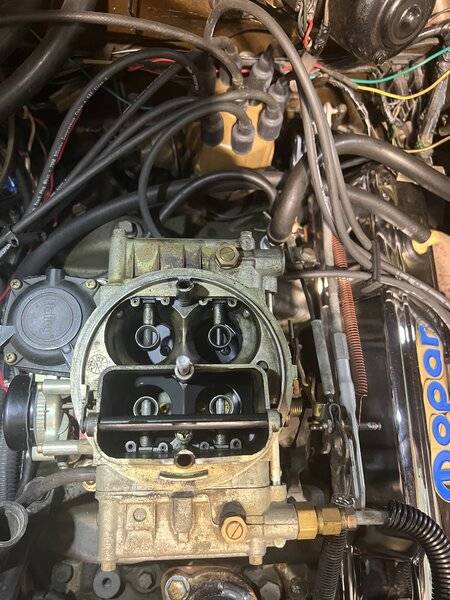

I think I have a timing issue. I had my dad start the car as I was looking at the carb with the air cleaner off. On startup there was a small *pop* noise and then a little plume of smoke came out of carb. Other than that it ran perfect and sounded good for the 35 minutes I had the engine on.

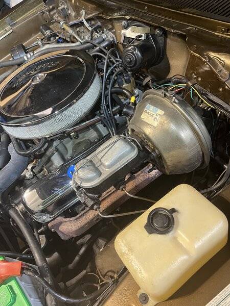

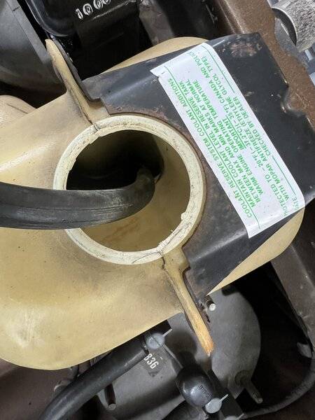

I took a few more pictures (somehow forgot the front of the car)…did it come stock with a coolant overflow? The radiator seemed full, coolant was clean but this overflow was nearly empty. Can’t seem to find what it should be filled at in the manual.
Thats a coolant recovery system. The should be coolant in it along with a 10231 radiator cap.
The recovery system picks up excessive coolant when the car get hot and returns it when it cools off. It keeps the rad full all the time and keeps the nasty off the street.

Thank you for the info! So it has some coolant in it but maybe only 1/2 quart (cold engine). I see that it looks like it can handle up to 2 quarts. Should I fill it a bit or does it need all that space for the potential hot coolant? Radiator itself if full.

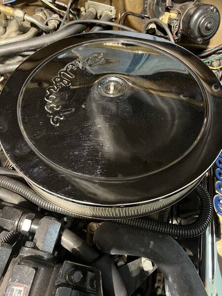

Air cleaner lid is black cause of backfires. Get back with timing #s also hood clearance causes issues with a-bodys and people try and fix with drop bases like yours small height air filters etc. which act as a full time choke. Notice your vent tubes are removed to allow for that low profile system. Try and fit the highest air filter and test with puddy with hood closed for clearance. You may have engine issues causing backfires. Nice car, good luck
Its ok but a tad more won’t hurt.
