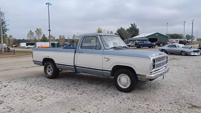

For clarity. I will NOT use NOS. Now that that's out of the way..... the question:
Will a bottom dollar 440 out run the 5.9 in our '80 D150. In other words, can I do a max of 500 bucks into the 440 and out run the 5.9 numbers.

the 5.9 numbers are 12.91 in the 1/4. 8.15 in the 1/8. 1.78 60 ft. on a warm/humid day
the 5.9 is 200,000 mile motor with an oregon regrind cam and 4bbl.

truck has 29x9 slicks, 4.30 gear, and a hughes off the shelf converter.
A hydraulic cam cut to Mopar 528 specs, single plane, 750 DP, headers and mildly ported head should eclipse 12.9 easily
If you do nothing to the dismal compression ratio of the 440 (IE put a different piston in it and bring em up to zero deck) it will have no chance against the 5.9. The best Ive seen from stock bottom motorhome 440s without boost is upper 12s in an A body. In a truck, I’m saying mid/high 13s.
