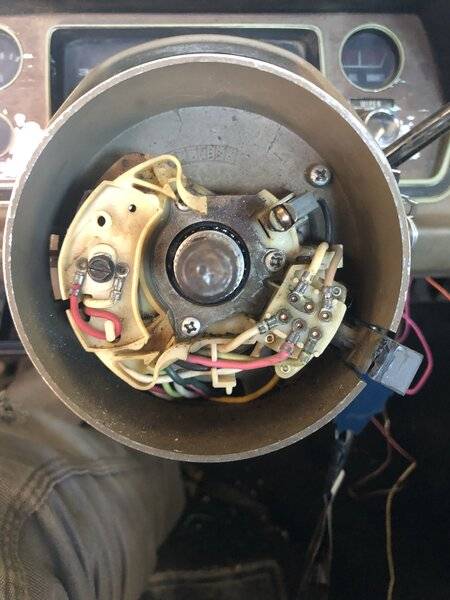

I pulled the steering wheel and I’m looking at the whole switch assembly in the steering column. Looks like 3?screws to remove but then I don’t know how I will be able to run the new one’s wires and plug through the mid section of the column. Maybe I have to reve that too
Someone else on this forum can get specific. I have not replaced one in years, so I don't remember. Get a factory service manual if you don't already have one. Do some testing first before going to all that trouble.

I had a left front turn signal issue on 67 cuda. A combination of loose bulkhead connection AND steering column connector with the long (deutsch I think) connectors. My hazard is on dash, while yours is on column. The 3 small Phillips screws(thru plate) hold the switch down.
Also wiring on column underside needs some slack. Double chk all connections before removing that switch. Rabbithole!
OP; try flipping on your hazards and apply a little pressure to the bolt that holds the indicator lever on The switch halves pivot around) and see if you get them to work. Don’t touch your brakes at the same time! The test may burn your bulbs out. There is some functionality in there that stops the brake lights from canceling your blinker when both are on at once. All that to say; I think it’s the switch
