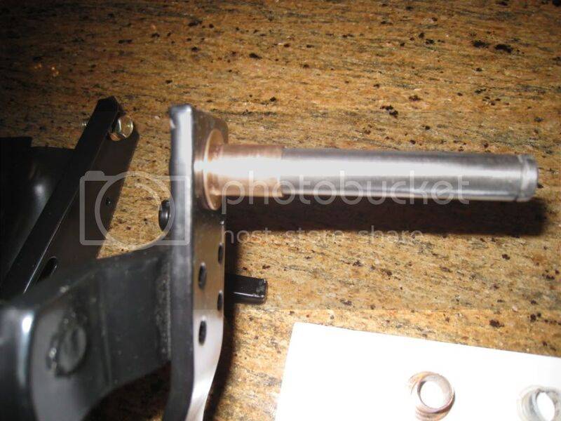

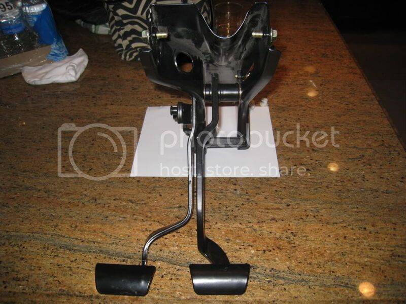

Hey all,
Yeah I know, old thread. I went ahead and made a set of bushings for moparmat2000, and made a few extras while I was at it for anyone who might still need a pair. These are the .810 (my measurements were +/- .002 on different pedal assys.) type. And I also turned a few sets of clutch bushings as well.
If you have a different size and need bushings I can make those too I would just need good measurements or preferably the actual pedal assy to measure (at least the for the first run) to get a good product.
Anyhow, They are $30 for brake or clutch bushes alone, or $60 for brake & clutch as a set. Just pm me.
Chris E.
PS, in the background of the first pic you can see the slugs of bronze it takes to make these things. starts out as quite a hunk of metal to make such a light part!
