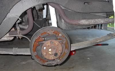

Has anyone got pics of there right, left front brake shoes and the rear. And also the rear I want to make sure it all goes back together the way it should.Some of the things i found taking apart this Dart makes me think,thease guys know what they were doing.So pics of the shoes and springs would be good goods.I have 10 inch all around.

Snake-here's some pictures that may be helpful to you
