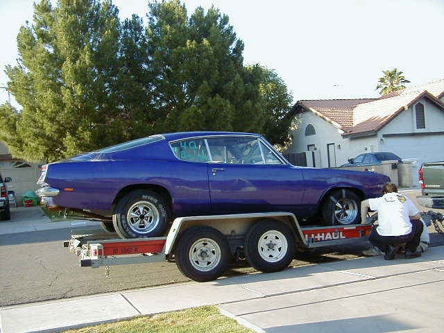

While we're on the subject, my car has some insane long-shackle springs in the rear... I dont even know exactly what the hell they are. I dont mean to hijack this thread, but can anyone offer me any insight? Will these make it harder for me to install other aftermarket springs in the future?
Oh, That's just not good. Just drop that nice looking Cuda at my house.
Looks like somebody used the extended shackle to raise the rear so they could fit bigger tires under it. Instead of replacing the probably worn out springs.
I would replace them with a stock set, or do what I did once and cut them down and use the closest holes, and cut the rest off.
When they were on my car it felt like the rear would sway too much.
Yep, Just drop her off to me, I'll take care of it.
Did I tell you? That's a NICE looking Cuda.

Thank you very much! I bought the Cuda in January as my first project car, and the weird spring setup was the first thing that I noticed was out of whack. I'm not even entirely sure how it's all mounted. I could take some more detailed pictures later, but I do think they just lowered the stockers to lift the rear up. It's not licensed so I dont know how it drives on that setup, but I'm sure it wouldnt be very good. Thanks again!
