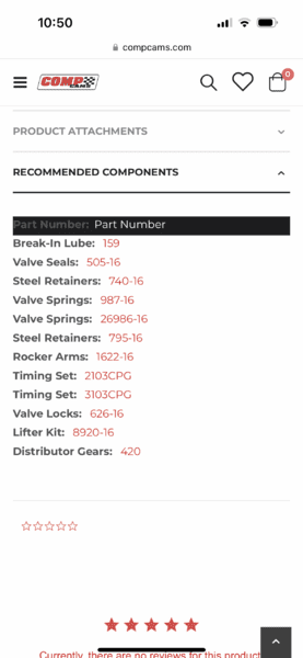

Is there a down side to the bronze gear, I expect it to wear more quickly, but how long should it last? I went by Comp's recommendation and put the bronze gear but my cam isn't billet.

Sorry about being not precise in my answer. It was regarding the post before.....and about comp showing on their website that for this particular cam 20-813-9 the bronze cam gear #420 would be necessary. These cams are made from cast cores (used a few of them), so no need for the bronze gear.

Regular gear works on the cam the OP asked about.
