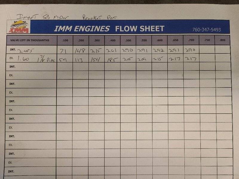

Here’s a flow test on these heads if that helps.

That's about 1.25 x na = boosted hp, those heads are easily 500-550+ hp x 1.25 = 625 to 688 hp. You'd probably want to keep the cam on the milder side same with boost.

You didn’t specify street/strip or a percentage of the two so I kinda assumed 50/50. With your gear, weight, tire size, converter, and cubic inches, I’ll recommend a cam that’s an off the shelf grind and should be easy to get if Hughes has cores. You might could get them to grind it on a short snout (magnum core) if you’re using a magnum front cover. If not follow their recommended parts at the bottom. And I’d definitely Use the single plane intake.
Edited to add; and if your not married to those rockers, I’d like to see a 1.6 with your head flow numbers.

Your first call should be to Brian at IMM. He’d probably be able to get you set up really well. He did the heads so see what he recommends.
I agree 100%. He may have had a camshaft in mind when he set the heads up.
I gave IMM a call this morning, had a good chat. The springs in the head now would work for a hydraulic roller cam but the pushrod holes needs to be opened up more. He gave me some pointers on how to do that but I may send them back to IMM to have them re-set up the heads. He also said the rockers are good to go at 1.5 but to thoroughly clean them and make sure to knock all the flash from the inside of the shafts.
