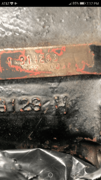

Can anyone help with info on these 4 spd numbers

Not the greatest pic, sent to me by seller.

Yeah its not too good, looks even worse than on my phone. I'll request another.
All Dan at Brewer's Performance Transmission can tell from those numbers is,
Its out of a 1971.
Looks to me like
1B314263 The B looks like a smaller size punch and turned a little sideways
PP883 3612 0058
3612 = Friday June 18 1971
0058 = 58th unit built that day
I just use the Maxwedge 10,000 day calculator and sometimes wonder if its correct.
Looks to me like
PP883 3612 0058
You have good eyes! I checked the picture on my phone which is a bit clearer and I think you got it. Appreciate your help.
