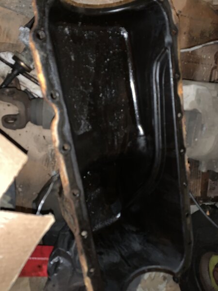

The Magnum oil pan from a pickup truck has a channel or guide for the dipstick to run inside of, so it goes down into the engine, curves rearward almost level with the ground, and then curves down again into the oil in the pan. Picture of the channel below. I don't have a picture right now of the inside of the 89 Ramcharger/truck oil pan.
Thank you. That channel thing is good to know, I was wondering how the dipstick got down in to the oil going from the front of the engine all the way to the rear sump.
