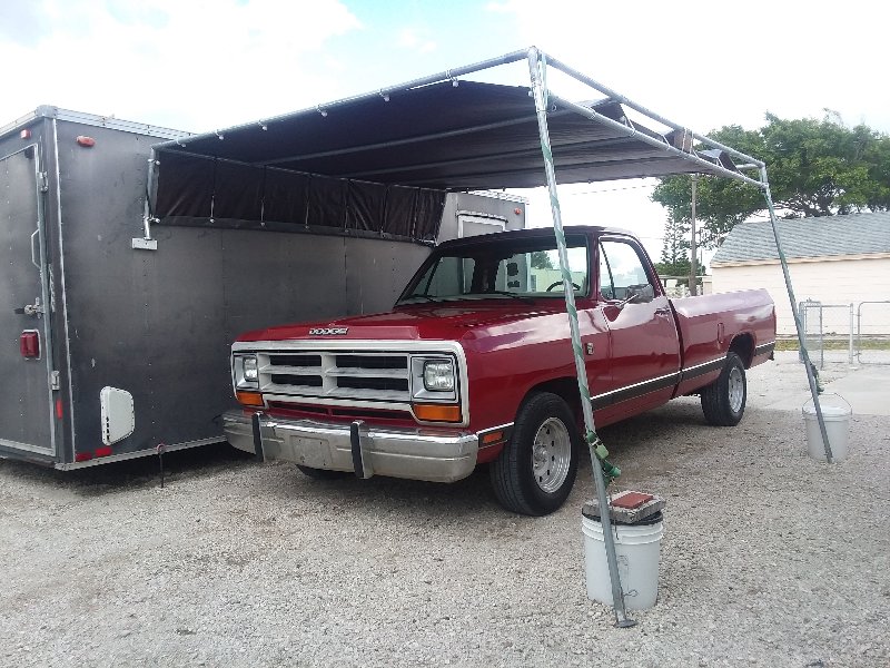

Personally I would look for one that is suspended above the car, like by a hoop of PVC pipe
1 1/4" galvanized steel tubing frame supported off the side of an 18' enclosed trailer. 10' x 12' tarp keeps the midday sun off, and the trailer side keeps the late afternoon sun off.
Setup so that it will drain rain off the right side of the overhead tarp.
Just yesterday added a 12' pipe crossways on center over the top of the tarp, helps hold the tarp down on the pipes in the wind.
Gives another dimension of strength to the tubular frame as a bonus.

Sorry......But a quick hi jack :) What size wheels are on your Ram George?
15" x 8"
225 70R15 Tires
Like the 70 series foot print.
Was really hard to find aluminum wheels to fit the large Bolt Pattern (5") and large center register hubs on the '89 Truck.
They were Ford Truck aluminum wheels with the correct bolt pattern, but had to open up the center hole with an electric router to fit the large dodge truck hubs for 1989.
Was a challenge to even find those wheels once I knew what I needed, but then a set of 4 finally showed up here on Facebook.
Happy with the final results.
Those lighter aluminum wheels help with performance too, less rotating mass to spin up.
