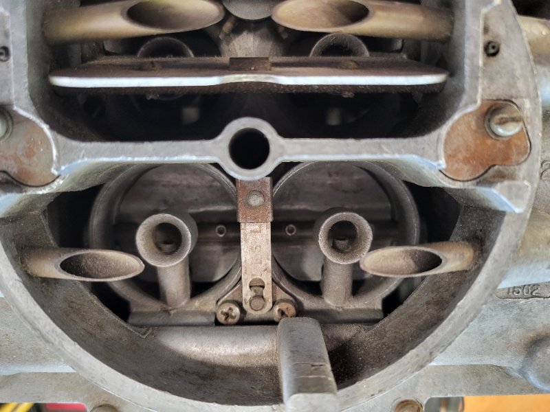

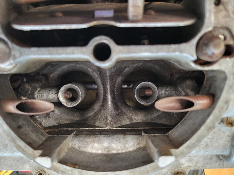

I had a conversation a few years back about AFB carbs and the "Auxiliary Valve Assembly"
Some call it a flap.
Anyway a statement was made that all AFB carbs had the Aux Valve.
Not true.
Carbs with secondary boosters facing fore and aft have the Aux Valve.
Carbs with secondary boosters facing right and left do not have the valve.

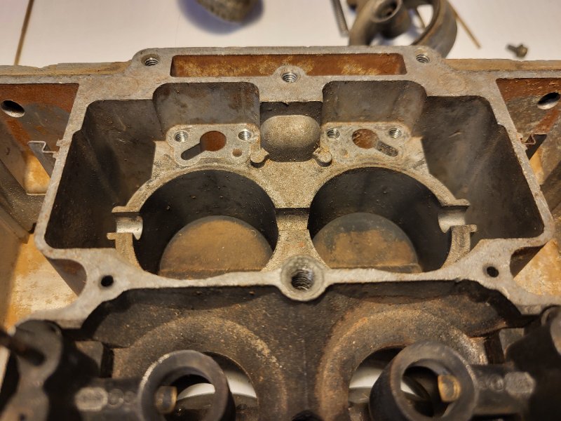

Any way I am searching for a valve for my 3083S carb.
I tried all the parts I have and nothing fits.
Also called the 'Velocity valve'. If it doesn't fit YOUR AFB, then your model was not designed to use the VV. There were a few different VVs, but they all fitted in the carbs that were designed to use a VV. There were 505 different AFB models....

Why would Carter machine the carb body with the saddles that hold the valve if they were not going to be used?

If the bottom pic in post #1 is your carb, then it is not designed to take the VV.
Can you post pictures of your carb? What do the secondary bores measure? I may have an extra Velocity Valve from a HP 273.
Velocity valves were used on HP engines: 440 HP; 273 HP; GTOs; Vettes; etc. They were gone by 1968, replaced by the AVS which had a spring loaded, adjustable Velocity Valve.

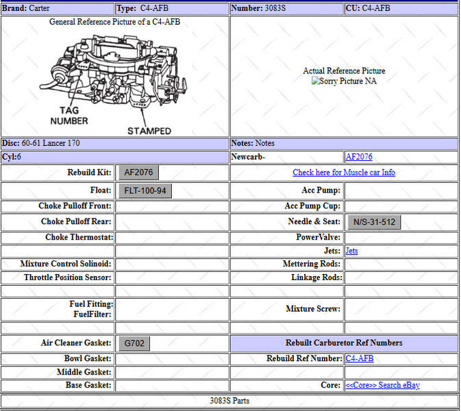

My secondary bores are 1 9/16, the primary are 1 7/16.
It is the small air horn style. 4.5 inch.
It's called a C4-AFB on this sheet.

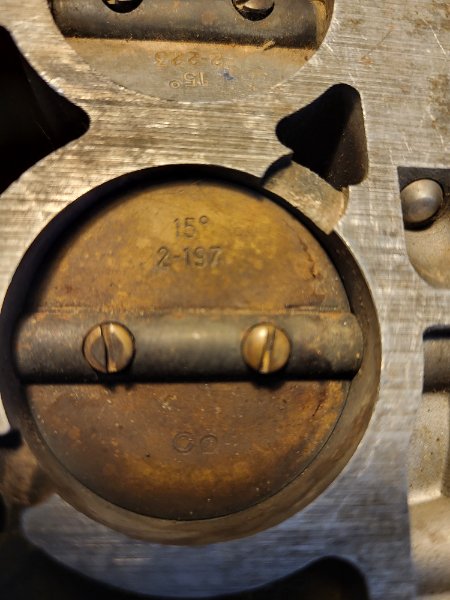

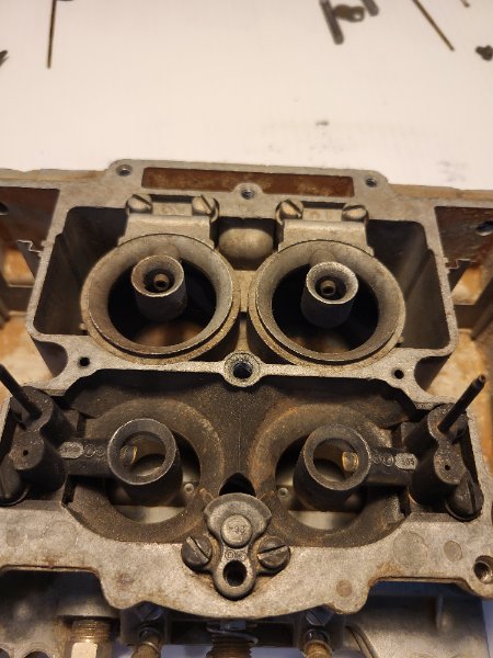

Are there numbers on the secondary boosters? Along the leg from the outer ring to the center booster.
OK, so it looks like your Hyper Pak AFB is very similar to a HP 273 AFB. 273 Secondary boosters are 222 and 221, Bore sizes are the same, so my guess is that a 273 Velocity Valve will work. I should have a spare, I'll try and find one.

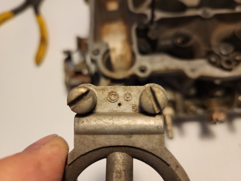

other than yourself. would anyone be able to tell by looking at it? Looking for the correct one is probably a better idea than my butchering. I could see me doing that, getting filings stuck somewhere and have all sorts of problems.
Contact Jon Hardgrove at The Carb Shop, Eldon, Missouri. He will have the correct valve. It is important to get the correct valve as there were many differences, mainly in the weights on the ends. Some valves had the blades horizontal, others the blades are angled. I have a valve that has alum weights on the end.
Obviously these differences will have an effect, hence the need to get the correct valve.
