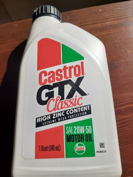

Anybody using this oil. I've always been partial to Castrol GTX oil. In the 70's worked in service at a big boatyard and a foreign car dealership and at both places that's all we used. Eventually I got into seriously working and spending less on hobbies, so I started getting my oil changed at the dealership or JiffyLube so it was pretty much whatever they have. Fast forward to today and I still get my y oil changed in my car and van, but I've been spending more time with my Mopars. A 69 b body big block, a 70 small block Duster and a 72 slant 6 Demon. To make a long story longer, I'm finding it hard to find a an old school oil for these cars, especially Castrol which in the 10/30 or 40 it all seems to be blended now. I did find this stuff and was wondering about your input on it. I'm going to use a Fram filter which was our go-to filter back in the day...that's another story though.

Do you drive any of them in winter? It’s definitely a decent oil, and it’s got zinc. Cold starts in under 50* weather would be my only concern. Not catastrophic, I would just make sure to bring it up to temp before any spirited driving. Oil pressure gauge would tell you when you are good to go. I run 20/50 in my bikes and my Mopar’s, but they don’t see any cold weather.
I am convinced you can put anything from corn oil to bag balm in the slants crank case and it will run just fine.
I currently use Lucas 10/40 hot rod and classic in a Chevy 307, a B-Body 383 and the 340 in the Duster. I did however recently change the oil and put VR1 20/50 in the 383 when I was diagnosing an engine noise, thinking it may be related to oil pressure(didn't wind up being related to this after all was said and done). Couldn't find Castrol 20/50 on the shelf locally. Great oil pressure to say the least with the VR1 20/50.
My Dart has a roller cam so I'm not too worried about the oil for that, but I have an 85 Toyota Supra with flat tappets. I used the Mobil1 0w-40 Full Synthetic because I felt 50 weight oil would be too heavy. The 0w-40 has 1000 ppm phosphorous and 1100 ppm zinc, so it's probably fine.

Anytime is says "will harm catalytic converters".... it has what you need for a flat tappet cam.

Not trying to open a new topic on the OP's thread, but, engine oil viscosity is determined by the internals bearing clearance's. Not by what looks good on the store shelve or what the other guy's are using.
Don't forget ambient temperature and application. An 8.5:1, 318 in a snow plow in winter isn’t going to use the same viscosity as a 10:1, 318 A body doing burn outs in 100* weather. Same tolerance/clearance but different application and ambient temp.
Have to disagree with post #19. Oil viscosity is determined by the oil, not brg clearance. Brg clear determines oil pressure.
I also have disagree with his comments about picking my oil based on "what looks good on the store shelf or what the other guys are using"
