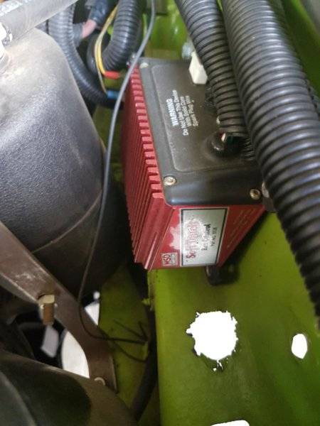

here's some photos. In the old coil shot you can also see the blue mopar ignition box.
In the photo with the red box it is labeled rev control

The red box appears to be what it says. An MSD rpm controller. Keeps from over revving the engine. I would leave it alone. The hard brakes suggest that you might want to see what the vacuum reads on a gauge. Might be too low to operate the booster.
